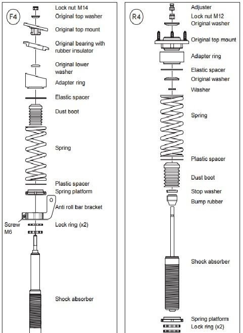

Not sure if this helps at all since I'm not sure if the Bilsteins go together the same way. Below is the assembly for the Front and Rear Ohlins R&T. Looks like a pretty good diagram showing what they re-use of the stock parts. Just for reference:

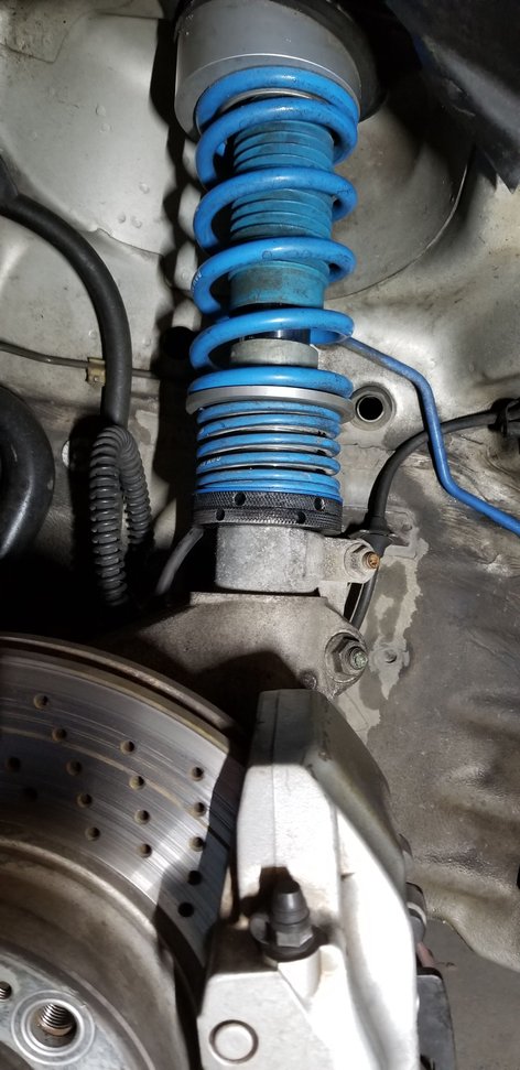

I found this thread pretty helpful so adding some additional notes, since Bilstein's instructions are really bad.
I have installed PSS9s on a stock 986 Boxster, so I was somewhat familiar with the install. In this case I was adjusting Bilstein B16 PSS10s that were in my 996 prior to purchase.
The 996 PSS10 shocks have a wedge shaped spring plate, see in the photo below. This plate seemed to be pointed in the wrong direction in my car, and it was unclear how these plates are kept in the right position. As usual, Bilstein's web site, their tiny manual, and terrible youtube presence meant looking elsewhere for information. Information that in my opinion should have been clearly stated in Bilstein's B16 PSS10 product documentation.
After reading these posts I realized I was not setting the adjustable locking rings at the base of the springs correctly, I had the locking rings too high. Noob mistake, I know.
I also saw from the photos here that the wedge shaped spring plate at the top of the PSS10 faces forward, with the thickest part of the wedge about 20 to 30 degrees from front facing, outward towards the wheel.
As we lowered the locking rings, the wedge would move around, but generally come back to position stated above. The porsche suspension design includes a bearing in the top mount, so the wedge floats on the bearing.
Setting the B16 PSS10 fronts to spec on the 996.

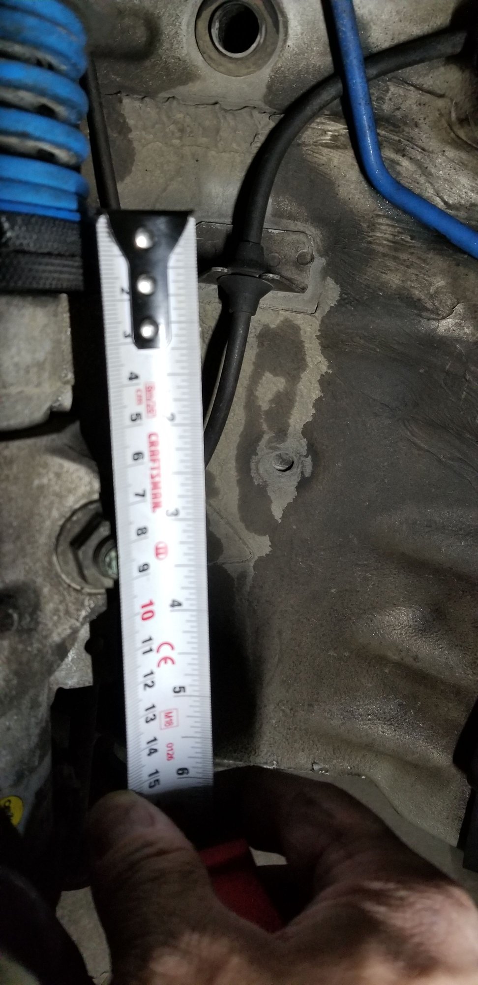

Below: Locking rings on the front are set to 83mm, basically at the bottom, maybe had 1mm additional space. We set it near the bottom of the 80mm-90mm range Bilstein specifies. The car is rear heavy with an LS3 so I want to increase rake to improve weight distribution and handling.

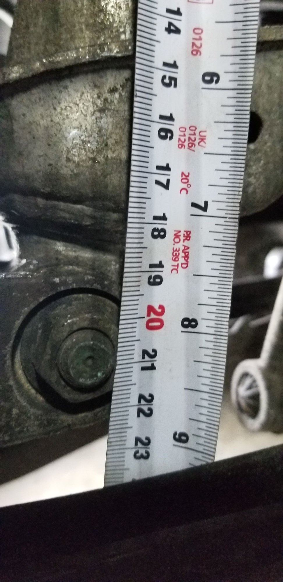

Setting the B16 PSS10 rears to spec.
The rear PSS10 locking rings sit substantially higher on the rear shocks.
We set the rear locking rings are set to 210 mm, the maximum of the 205 to 210mm range specified in the Bilstein manual.
I will post a picture of the car later, I don't have one since this adjustment on the weekend.
