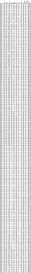

One of the durametric logs: http://thumbsnap.com/f/7VawtdjK

Here are the first 53 minutes of testing;
http://thumbsnap.com/E7LgyFqfigh
And 6 laps at high speed:
http://thumbsnap.com/f/dnS5J8pZ
