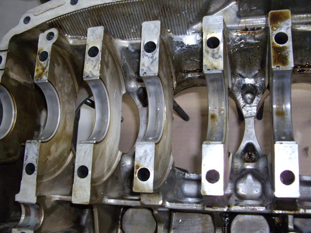

In Switzerland the car is still worth 60-70K USD, I have some pics will post soon, R.I.P my previous engine, 2 connecting rods were just bent and 1 piston shattered into 100 pieces. Very Impressed with Sportec, such a massive tuning shop. They are doing lots of stuff for Russian Clients and sorting out some 9FF tuning disasters

Pics
Pics

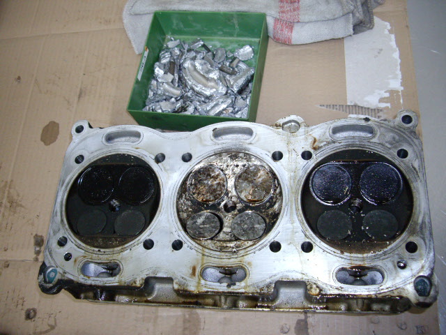

More

Yes and that's a piston in the green box, now what is the telephone number of EPL tuning who apparently removed my boost limiter when my AMS billet turbos were fitted .....

i never knew such a small connection on the wastegate would create such a disaster ... myabe i should really go NA next time i buy another porsche!
