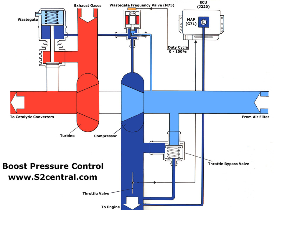

There is something wrong with the explanation of the function of the n75 valve. On one of the drawing I got, the N75 helps the spring to close (the first one at the beginning of this thread) and on the other one work against it to help opening of the valve earlier than the spring force. In the past I have read that some people are running with spring pressure only. That mean Porsche engineer design a spring that provide a protection against high boost since the N75 is helping the spring to open the gate earlier ????? I think the second drawing explain the protection we have....Plus why the ecu would aloud the engine to continue running if it knows there is too much air for the amount of fuel it can provide. There has to be a maximum the ecu is able to handle by some kind of limitation.... I am trying to understand why, suddenly, we got this catastrophic failure that we never had before....
Also look here: There was no catastrophic failure with a malfunction of the N75: https://www.6speedonline.com/forums/...rging-fix.html
There was some mis-information early in this thread. The wastegates are CLOSED unless there is pressure to open them and let the exhaust gas bypass the turbo.
Without the line hooked up, there was no pressure to open them thus they kept boosting.
They are not like air brakes where a line failure puts it in safety, a line failure on a boosted car will make them overboost. It is like owning a gun, you have to check the safety, otherwise bad things could happen.

Look at the link provided. "Janker" had a failure of his N75 and the maximum boost he got was 1.3 which is not something that will give you a bent rod or destroy your piston! I also don't understand why Porsche engineer did not provide any protection. (I know they are not perfect, vario cam, spoiler hydraulic,slave, etc etc...) I've read in the past many cases of N75 failure and never saw a failure like Richard's one. I am like you Chad and don't want anybody to panic about it and I'm trying to found answers....
