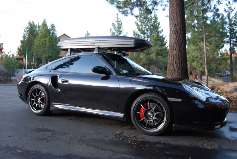

Nikolas has a brilliant futureNikolas has a brilliant futureNikolas has a brilliant futureNikolas has a brilliant futureNikolas has a brilliant futureNikolas has a brilliant futureNikolas has a brilliant futureNikolas has a brilliant futureNikolas has a brilliant futureNikolas has a brilliant futureNikolas has a brilliant future
These are 265/35/18 blizzack lm60 on 10" rear rims. Look closely and you see they are stretched. Adding another inch would really angle those sidewalls.

Yes, accept you will see the same issues with height. Even the 275/35/18's are too tall at over 26" and will rub just like the 295's you already have. Wish I had better news for you, but I researched the crap out of this last winter. I finally bit the bullet and bought the wheel tire package you see in the image I posted. I would have loved to find a set of 295/30/18 snow tires and save the money. O'well, the OZ wheels are really nice and not that expensive. Also that picture was before I installed the 15mm spacers. It looks much better now.
