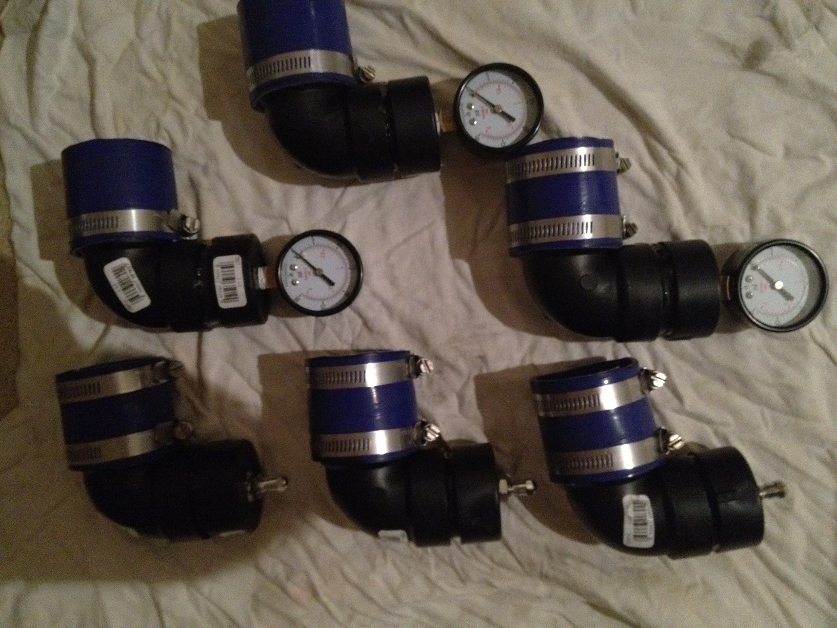

I have made a few more pressure testers with the recommended tire stem. See attachment. (if I am going to make one, might as well make a couple)

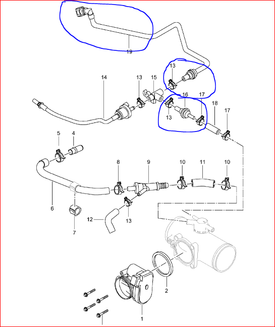

I'm cross-posting my own post from the other boost testing thread into this one since you just did this, and this thread is getting the replies as of now. I'd appreciate some insight on the work you just did. Thanks in advance.
Can someone help clarify the procedure of what needs to be blocked off if testing is done at the throttle body?
I did a pressure test when I first got the car, installed new DV's & boost hoses and things were going pretty well. I took care of a couple of leaks, but always had a slight hissing when above 15psi. At 5psi it would hold steady, but I don't want "good enough". Now that I've read more I want to give it another go and I'm thinking there's a decent chance the check valve going coming from behind the TB and going to the drivers turbo may be the culprit.
Part number 996-110-135-70 #16 on this diagram:
However, I'm guessing this needs to blocked to do the testing I'm suggesting?
When I go at it again, I'd like to test behind the throttle body.
So my assumptions are:
1)remove y-pipe & throttle body, make adapter plate to test pressure up to 20PSI
2)try to make a better seal on the oil filler cap with a rag or such
Questions:
Q 1) Does anything else need to be blocked off if doing it behind the throttle body plate? (assuming I try to tighten seal on Oil filler cap)
Q 2) What is the best way to jump the starter to turn the motor some if it's leaking through open valves, or is this even worth attempting?
Q 3a) If it is indeed the check valve mentioned, or one of the related check valves, whats the best way of testing / accessing to replace? I was planning on using the soapy water test to look for bubbles.
Q 3b) Do the DV need to be removed so you can even access view of it?
Q 3c) Does the motor mount bolts need to be lowered to access it?

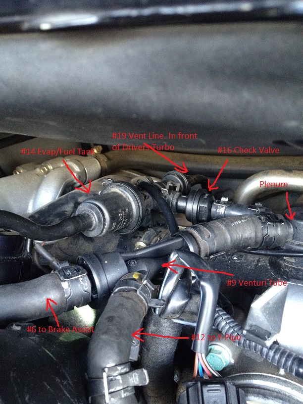

I am becoming intimate with the vacuum/pressure lines on the 996 turbo. Here is what I know and hopefully it will help with your testing...
The boost/intake hoses are pretty self explanatory. Things get interesting at the Y-pipe, throttle body and the plenum behind the throttle body. These are the parts with the vacuum/pressure lines that go off to other areas.
I will also try to provide pictures and I will answer questions I had asked earlier as well.
- The Y-Pipe has a couple of nipples - one comes off the #9 venturi tube and the other goes to the N75 waste gate control switch.
- The TB has a couple of nipples. They have the #21 check valves connected and the best I can tell, they are designed to hold vacuum. (My #21 check valves were working and held 20 psi. I have new ones and will most likely replace them anyway) I need to better map out where those lines terminate. They are 1/2 white and 1/2 black. (#21 check valve - 964-110-950-01 ($13/ea))
- The plenum is where people seem to experience the most issues. I know I did. This is where the #9 venture tube also connects, as well as the #16 check valve and oil reservoir vacuum hose.
------- #9 Venturi Tube - routes into the Y-pipe with a check valve, and it looks like it also goes to the Brake Assist line. (With another check valve) The line going to the Brake Assist was broken for me. It would not hold more than 5 psi of pressure and was leaking around the outer edge to atmosphere. (Replaced - 996-110-652-70 ($50 local dealer with PCA discount)
-------- #16 Check Valve - goes into a T. One side of the T goes back into the intake before the drivers side turbo and is still in the metered system. The other side of the T goes off to what I believe is the Evap system/fuel tank. Mine was sticking and when I checked it in the car, it was stuck open. Once it was removed, I was able to free it, but you could hear it sticking and making a "popping" noise under vacuum and boost. (Replaced - 996-110-135-70 ($27))
--------- Plenum Check Valve - The plenum itself has a check valve built into it. It is the large hose on the passenger side that goes Oil Reservoir. It is designed to prevent boost pressure from going into the oil system. I tested mine to 20 psi and it held. The other two ports are wide open and go to #16 and #9.
I am putting things back in, and will pressurize the system to verify that none of the hoses, or clamps are leaking.
-Shawn

mbgt72,
Disclaimer - this is coming from someone who has yet to perform a successful pressure test. (But I have found issues with DV's, #9 and #16 so far.)
Questions:
I think this test would help localize issues, but I would start at the turbo's
I am going to see how lucky I get without rotating the motor. I did test the check valve in the plenum which goes into the oil system and it checked ok for me. If I need to rotate it, I will just turn it over with a quick blip.
Soapy water showed my #9 leaking, but it did not show any issues with #16. It wasn't until I pulled the hose from the plenum to the Check Valve and put a pressure tested on it that I noticed it was stuck open. What was odd, was I was not leaking air down the #14 line.
I did not remove the DV's. See picture above.
The motor was lowered to gain access. Otherwise it was just way too tight for my hands.
