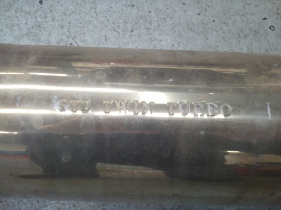

The exhaust has one large silencer, and has 'GT2 TWIN TURBO' etched/stamped into the top of it

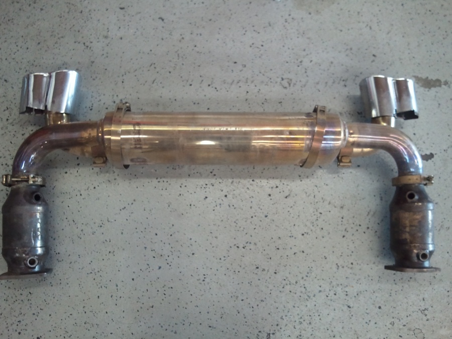

I'll get a picture uploaded now

Ideas??

Smile
Originally Posted by ant_8u
Ideas??
Gen 1 for sure. Just like mine. I have the LOUD version . It is LOUD and it does have some drone between 2200 and 2500 revs. Lovely deep rumple, with gorgeous sputter, bubble and squeak (could not resist) I mean, a deep burble / gurgle and popping exhaust when you release the throttle and some serious roar about 4500 revs. Very loud at start-up, quietens down a bit when the engine is hot. Forget listening to the entertainment center radio, good for when you have an argument with the better half.

I think that is gen2. gen1 is one "cherry bomb" on top and on one on the bottom. Bank 1 exist on bank 2 side of car. you can easily see its two mufflers.

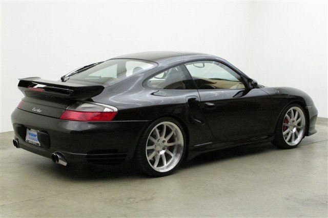

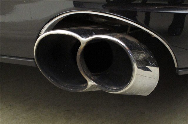

I found a picture of my Fabspeed tips and the bacxk of the car

Original Gen. 2 sport with 100 cell cats. Most power independently dyno tested by Imagine Auto back in the day. You will have resonance/drone with this system and if those are the original sportcats you might have a CEL. We can always swap the 100 cell cats for a new 200 cell unit (email or P.M. for price), but we will need those cores as they have a Marmon flange that we no longer use. About 2-3 years ago these exhausts were highly demanded and I saw a few sell for about $2,500.
