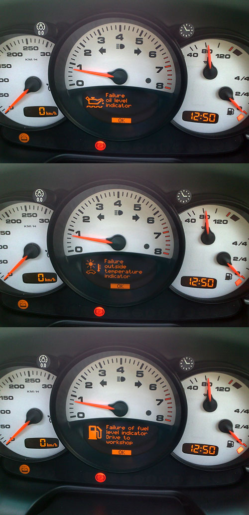

I was doing a do it your self project and Fed something. I was replacing the instrument surround to arctic silver. It all seemed to go well. I replaced the speedometer panel with the new silver instrument surround. I reconnected the battery, and turned on the car. I got an error message failure saying " failure of fuel level indicator", and my gas gauge says Empty, despite the tank being full. HELP.....anything I can do??????

Sounds like the connector behind the gauges is loose. Might need to check that.

Thats what it was I think. Unconnected and then reconnected all the gauges, then let her sit a few mins. Cranked it, and she is better than new!!! Eric, the parts looks awesome man. I will post pics soon!!! Thanks!!

I had the identical problem as Testndoc, except my car was throwing up multiple errors
Cause:
All of the instrument cluster connectors had clicked into place and latched correctly
.....but was one of them was actually sitting 2-3mm higher than the others !
Interesting that it can click and latch, yet not actually be seated properly !
Make sure they all seat to the same height !
