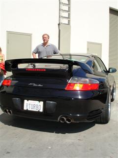

Here's a pic...

Beautiful.

Is that a Strosek wing on it?
