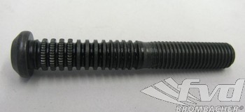

Old Apr 1, 2012 | 08:17 AM
cosworth's Avatar
Joined: Jan 2011
Posts: 123
From: Milan (Italy)
cosworth is infamous around these parts
First picture is 964 rod bolt , second one is 993 TT /996TT/ 997 TT rod bolt
