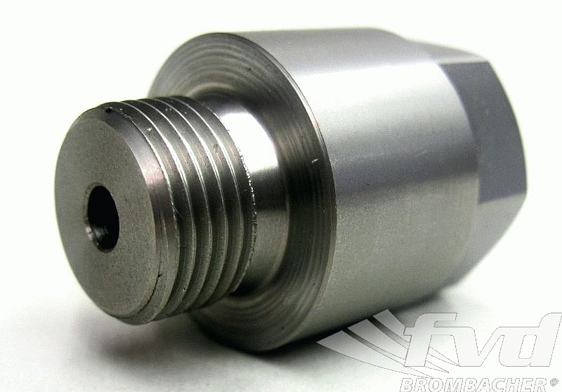

Steve, do your extenders have a reduced opening at the bottom? it will work if you go down to about 5mm. I have found that is what does the trick not just the length...

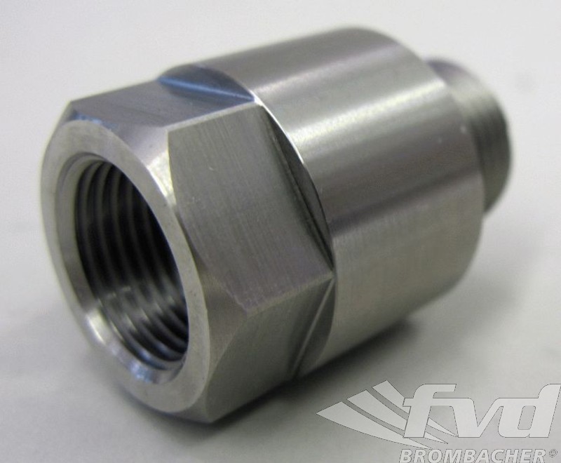

Yes, I have the FVD version (I bought cheapie aluminum fleaBay ones originally...they weren't worth a darn and didn't even allow me to install them, thread-wise) that do bottleneck down to a very small hole at the bottom. These are the 'short' FVD extenders, but are rather long already.
I believe FVD does sell a longer version of them as well, but since this is the only thing I'm looking to change I figured I'd throw the question out there.
*EDIT* I included a picture of the model I have from them.

I successfully used these longer version units. Worked very well. I dont know what brand they are. I got them from blockhed

Thanks TurboTodd. Those are clearly longer than the standard FVD ones I have. I suspect that in order to avoid a re-tune I will have to pony up and get a longer set like that, as those appear to be as long as the other FVD model as well.
