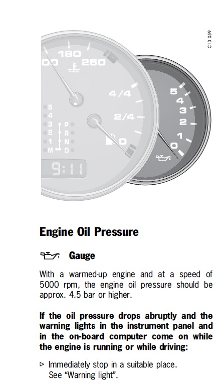

I recently purchased an 03 911 TT. The past couple of times I've been driving the car, the check oil signal comes on. While I'm driving the level is usually between 3 and 5 and when it idles it's consistently at 3. I went to take the cap off and didn't see any stick to measure. Should I just add some oil and see what happens? Any help would be much appreciated. I did some research and saw this was a common issue on 2001 911's...

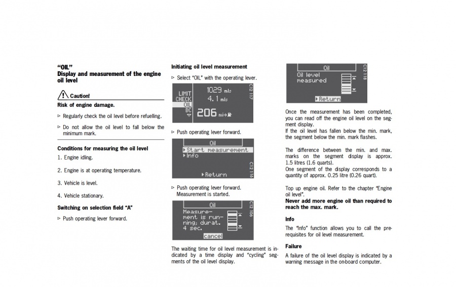

First, the indication you see on the gauge is a pressure indication in bar not a level.... The level can be found with your on board computer, only with the car level, engine warm at idle and the car not moving. See pics...

per jpflips advice, you need to better familiarize yourself with the stalk on your steering wheel that controls all of the settings and features of the onboard computer.
there you will find the feature that allows for oil level check. also, if you have the manual it helps to at least skim through it to better get to know the features of your car. do NOT add oil without knowing the current level(s).

HI,IMO you should be at between 1.5 and 2 when your engine if fully warmed up...
That can be confirmed when you do your dash check for oil level,,I have found out when it takes 5 secs. for the level reading,the oil is fully warmed up...When the oil is not fully warmed up it takes longer for reading..
Just for a heads up the timer is based on how long the car has been at idle not oil temp. Sit at idle for 10 sec once it's warmed up and the timer will usually start at 5 seconds when you check oil level, after it's done rev your motor and immediately after it drops to idle check again and the timer will take longer as its waiting for the oil level to settle.
Hi,I dont think so..My oil level check will never take 5 seconds at idle when the car is not fully warmed up and when it is fully warmed up it will always only take 5 seconds at idle......
IMO..It goes by the thickness of the oil,as it heats up it gets thinner,flows quicker, in which it takes less time for the level reading...
Just sharing what I have saw on my car..
Huh mine won't even check oil level until its fully warmed up otherwise it'll display "oil level not possible engine not warmed up" I have an 01 so maybe different from newer years?
+1.
@johnspeed; you should have it checked, always taking less than 5 seconds is not right. It does not go by thickness of oil but by engine temp. If oil is not hot enough it will display message "oil level measurement not possible, engine not warm enough" as TTurbRon says.
