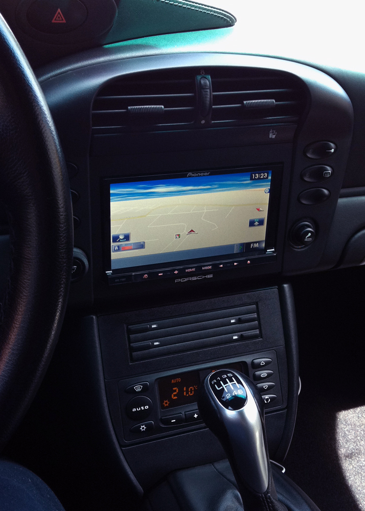

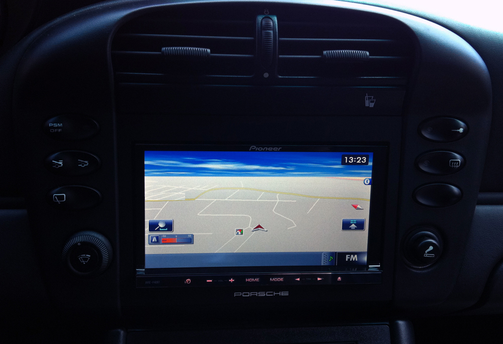

Finally did it. Newest AVIC in the car.
Few issues;

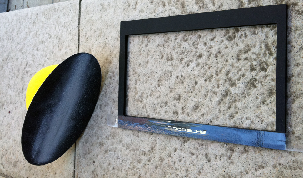

Trim from eBay is 1mm to thick (for cup holders cars – they catch it). Had to sand down to size. Used 100 and 400 sand paper.
Dimming works once headlights are turned on. Great unless you live in Europe and are required by law to have lights on during the day.
Fitted additional sensor for day/night illumination change.
Unit is superb. Great response – happy. Boot up time; initially car from overnight sleep 15 seconds. Any additional boot (within 3 hours) radio starts playing within 2 seconds (albeit logo booting for another 5).
I tried all units, but this one was my choice at the end. Happy.

Install looks great! How hard is it to get the A/C controls relocated down below? Any additional/different trim pieces required?
Old May 12, 2012 | 04:28 PM
Terminator's Avatar
Joined: Jul 2007
Posts: 1,276
From: London
Rep Power: 88
Terminator has a brilliant futureTerminator has a brilliant futureTerminator has a brilliant futureTerminator has a brilliant futureTerminator has a brilliant futureTerminator has a brilliant futureTerminator has a brilliant futureTerminator has a brilliant futureTerminator has a brilliant futureTerminator has a brilliant futureTerminator has a brilliant future
Not difficult. Yes trim for aircon required. eBay kit provides it for you.

Your installation really looks clean and professional. Nice job!
