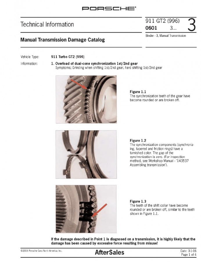

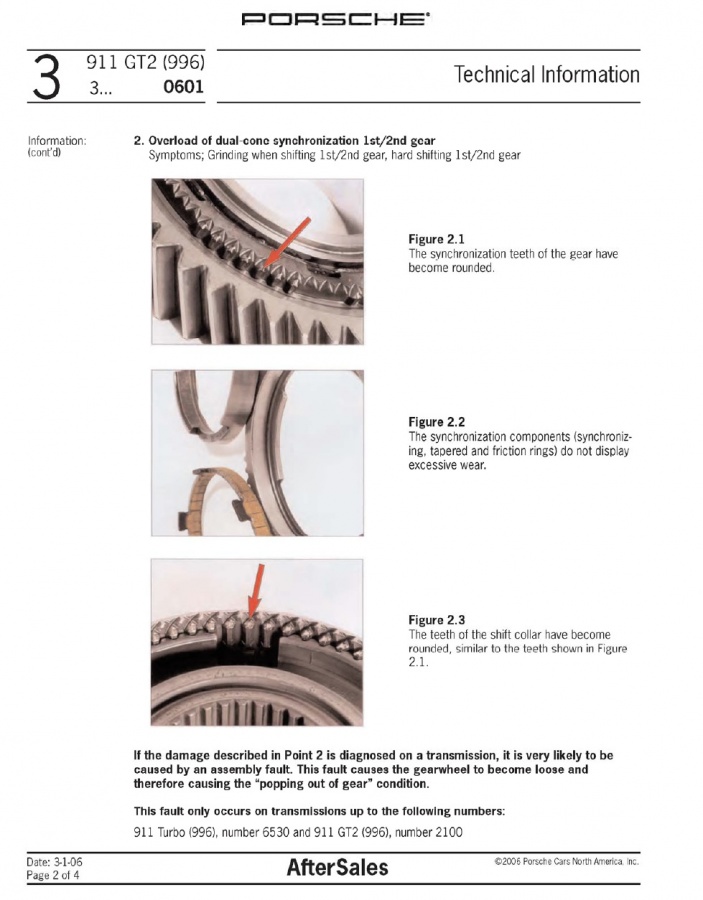

I went through all the transmission related TSB and the only one that went further than just saying "repair as needed" is this one: And it is for the GT2....
the ammended porsche docs i saw were on that machine they have in the service bay.. looks like an old microfiche reader lol. all techs have it at their bench at pcar dealers. you know the one. it has to be an ammended doc as they have gone out of their way to say there is/was no issue with 2nd gear in these cars.. until they reversed their position, at least in "some" cases.
