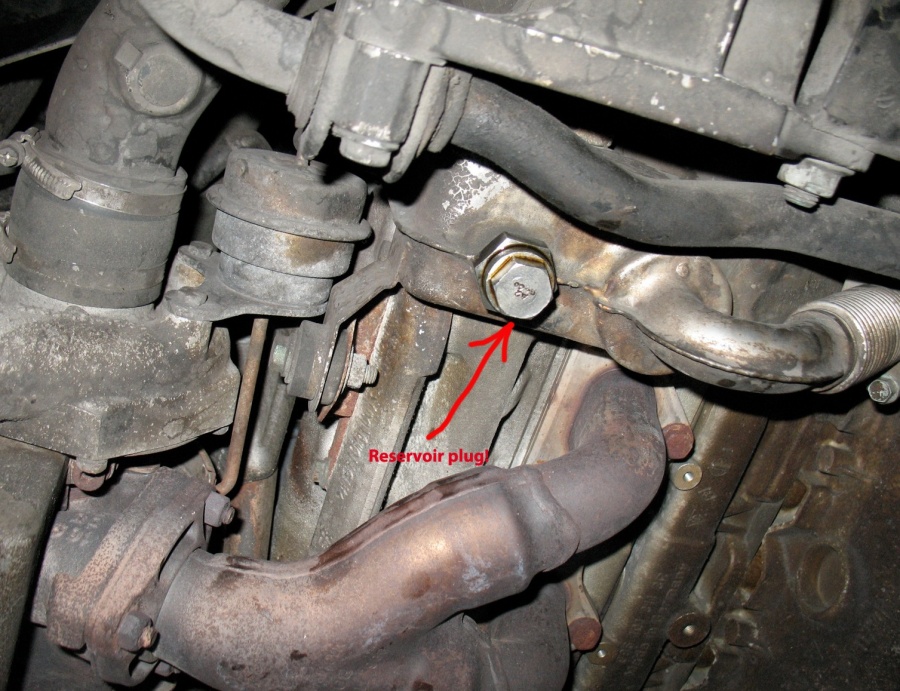

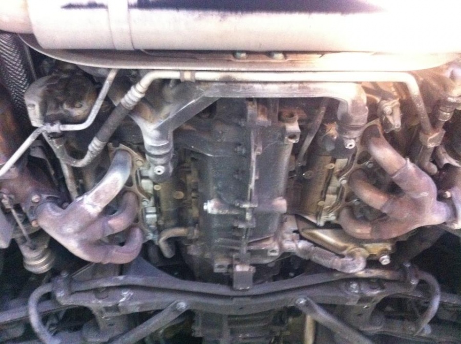

Here is a pic of the bottom of a 996 Turbo. On the middle center, there is the shiny crank case drain plug. This is what I think you drained based upon your description. On the lower right of the picture, there is a "j" shaped pipe going to the right, coming from the crankcase. This goes to the oil resevoir and to the right of where the bottom of the "j" goes into the tank, you can see another drain plug (Hex head). JPflip also shows this plug but directly underneath it. This also needs to be drained. Be sure to use a second wrench (I think 27 mm) on the tank itself to offset the torque of undoing the tank plug. Hope this helps. I PM'd you if you need local help. Good luck.
thanks, now I get it!!! I'm not going to hassel with the turbo oil canisters. The plugs seem welded in place, an allen wrench did not seem to budge them, What do you think? Thanks again

Hi, I doubt an allen wrench will work. You will probably need allen head sockets, which are either 3/8 or 1/2 square drive with an appropriate drive bar or ratchet. Judging from your posts so far, it seems like you have alot of enthusiasm but not as much actual wrench time? Have you downloaded the shop manuals on this site? there is a wealth of information. Again, good luck.
