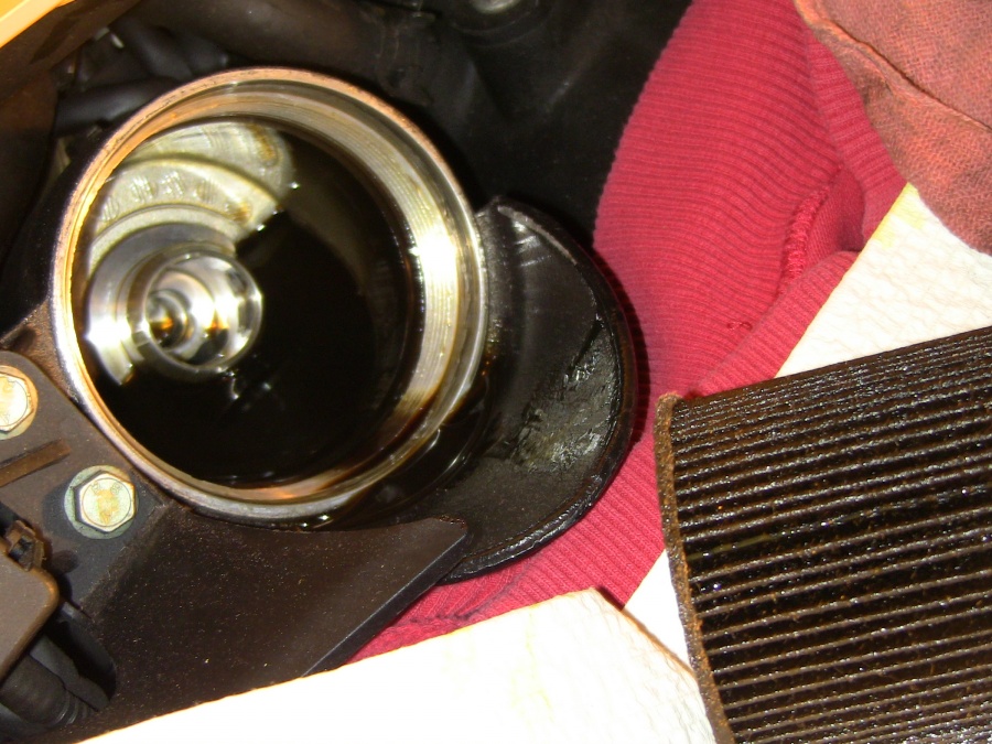

I just changed the oil last week. Don't bother draining the turbos. The total amount of oil from both turbos filled about half of a Jello Pudding cup. You know the ones you buy already made for you in the super market.

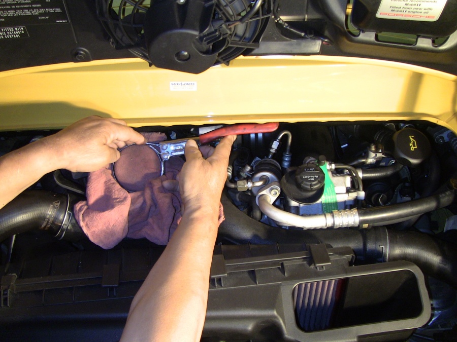

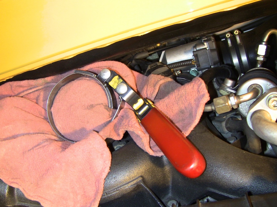

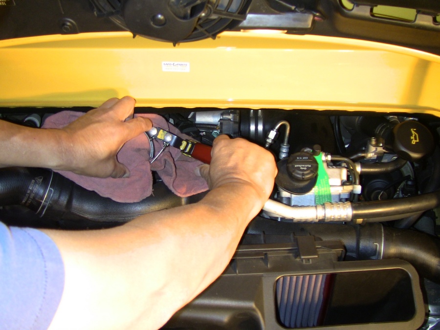

Also, the oil filter canister is on very tight. The Autozone wrenches do not work. I've tried every one of them. The only ones that work is the official Porsche one and the Lisles #53700 wrench with a swivel handle. My mechanic friend used the Lisles one and loosen the filter canister in less than 10 seconds. It's on very tight. Also, the swivel handle gives you enough room to get additional swing room and get beyond the obstructions. See pix attached. 3rd pix show how a non swivel wrench hits the engine compartment lip. Also, the first one shows the swivel wrench swinging beyond the 'Y' pipe.
Use a rag around the filter canister, so you don't scratch it. Also, there is very little oil in the filter assembly. Use a rag or a syringe to get the little bit out. Probably about same amount as in the two turbos. Not much compare to the 8 quarts you've already drained. So, I don't think it's a big deal if you've left that amount in the turbos and the filter housing.
