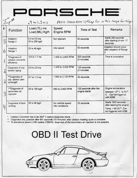

File Type: pdf

Here is the procedure to bring MIL status to readiness.
However, as others have suggested, some aftermarket "flash" tunes disengage some of the emissions systems and this will preclude the vehicle from reaching a completed readiness status.
I just went through discovering all of this myself over the last 24 hours. I had the same exact issue as you, however, I believe my car has the stock tune. This worked for me.
Drive cycle procedure:
Start engine, let idle for approx. 2 min, 10 secs.
Accelerate to 20-30 MPH, Maintain steady speed for approx 3 min, 15 secs.
Accelerate to 40-60 MPH, Maintain steady speed for approx 15 mins.
Decelerate and come to a stop. Then:
Idle in Neutral for 5 mins. (manual trans.)
Idle in Drive for 5 mins. (Tiptronic trans.)
During the drive cycle, do not exceed 3,000 rpm or 60 mph.
Good luck.

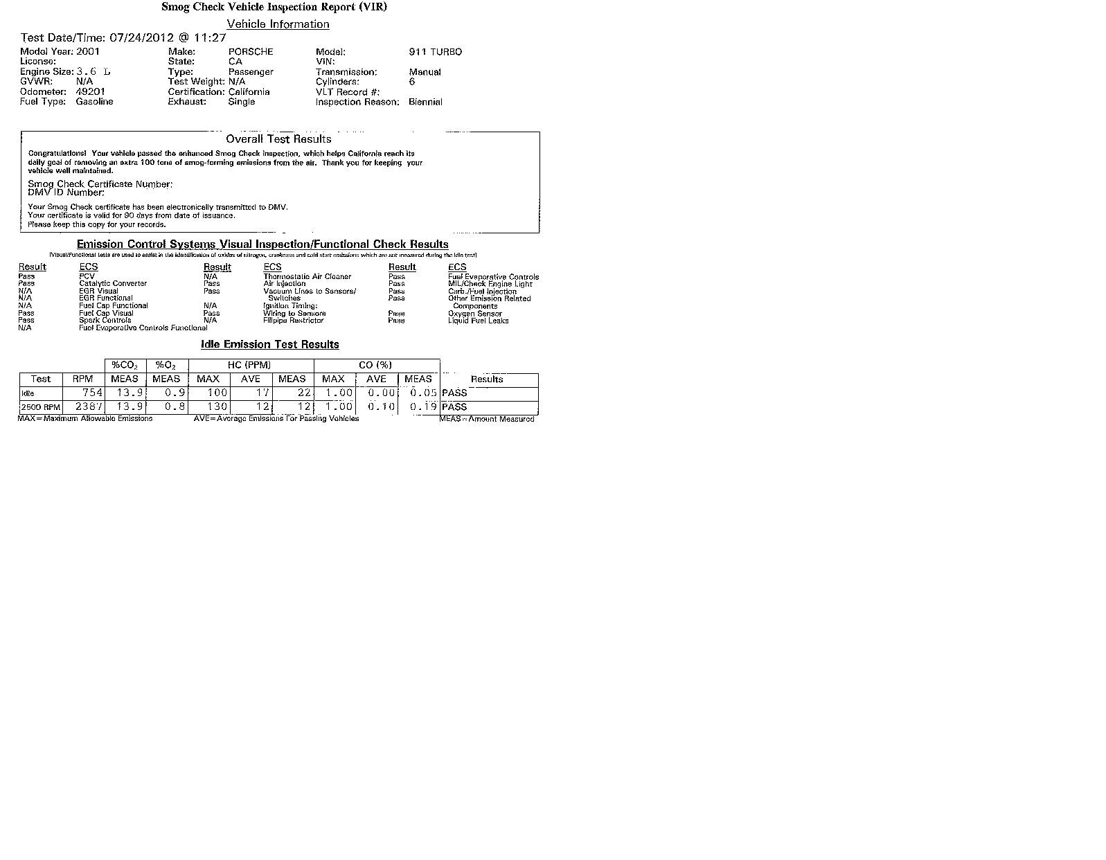

I ran several of the "readiness" drives over the weekend and it never cleared either of the two open indicators. Dave(EPL) came through and sent me a new Cali-91 file and a Flash cable and within 15miles of easy driving one of the indicators went green. I was finally able to bring it in for SMOG and it passed with flying colors including the readiness sensors.
Big shout out to Dave at EPL for coming through with a revised flash program and cable on such a short notice all while Tony was out on vacation. Paid my registration and am legal again for another 2 years.
You are a superstar Dave!
Name:	CA Smog pass.png
