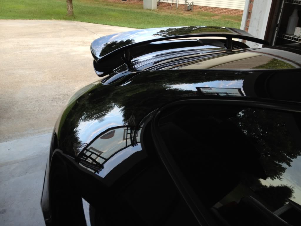

$3.00 fixed wing kit
I'm not a big fan of the fixed wing look, but I have a broken pump, I'm getting ready to install an new Tech Art Type 1 replica wing and I have to have the wing up to remove/install the wing.
Given this, I had to figure out a way to do a fixed wing.
1. Go to the hardware store and purchase a 1/8" steel rod.
2. Go to the automotive store and buy some brake cleaner.
3. Cut two 3.4" long pieces
4. Remove the pump and lines (optional, but cleaner)
5. Spray brake cleaner inside the ram to clean it. If you have some compressed air, you can spray that in to dry up the brake cleaner
6. Manually pull the wing up and put something between the wing and deck to hold it up (I used a 3" section of 3" silicone hose).
7. Put the 3.4" long 1/8" rod you cut into each ram (you will have to push slightly to push the piston up inside the ram).
8. Reinstall the short banjo bolt to hold the rod in.
9. Manually lift the wing and remove what ever you were using to hold it up.
IMPORTANT: DO NOT use the bolt/rod to force the wing up and be careful when you lower the wing. You do not want to bend the rod inside the ram. It can be removed, but is it a PITA.
The rod cost me around $2.50 and I already had brake cleaner, so it's very economical and you don't have to take the ram apart, or mess with the spring inside the ram.
FYI the total weight savings was only 3.4lbs.
Later, Steve
Here is a picture after the mod

Brake cleaner will destroy the seals inside the rams, just FYI. The chemicals in them can have adverse affects on certain rubbers and vitons. I would just drain them and leave them that way with a residue inside, isnt going to hurt anything with a little pentosin still inside.

I like the idea & simplicity. Do you think the rods would be sturdy enough to stabilize the wing @ upwards of 200mph?

Well the wing is up, and it looks clean to me, so good job.
The seals are going to dry out regardless unless you cycle your wing regularly. They are at the top of the rams, so unless your using the fluid to push the pistons up, the seals are getting very little lubrication. This is probably why the seals fail in the first place.
Plus, since you're using the stock banjo bolts, the fluid will leak into the hot engine bay. I don't believe one quick shot of brake fluid followed by a blast of air to evaporate it will due significant damage.
Later, Steve
I had read in an earlier post that our wing generates 60lbs. of downforce at 190mph.
I applied more than 60lbs. of weight on the top of the wing after the installation without any issue.
Later, Steve

Originally Posted by Prche951
in all the years I have been viewing this and other 996tt forums I have only read of one fire and it wasn't caused by this, so although what you say may be true, it has never happened to my knowledge with any frequency. When things like that happen, the car community finds out quick, like with the ferrari 458 fires.
I doubt there would be a fire, but my point is cleaning them out with brake fluid is even less of a risk.

I basically did the same thing. I machined a couple of pins out of stainless rod and inserted some short bolts in place of the banjo bolts. Then I got tired of the continually raised wing and just took the whole thing off. I need to make some plugs to cover the ram holes in the rear deck.

It's a simple 1/8" diameter steel rod. Most home improvement stores will have it.
