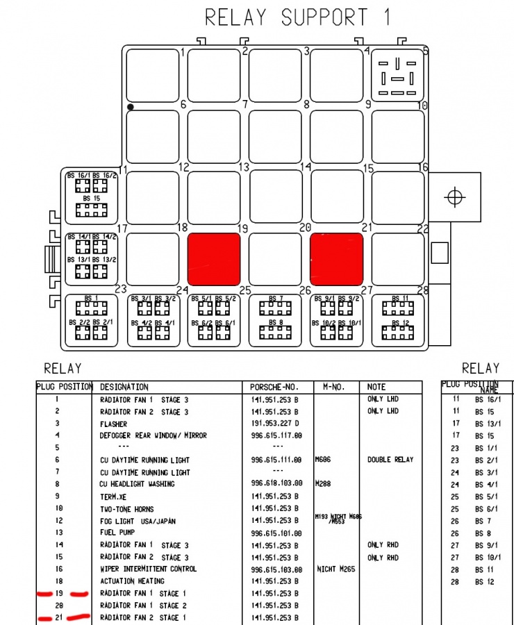

Take a look at fuse C8 for start. There are some relays and of course malfunction of the fan can be a possibility....

If the fuse is intact, eliminate the relay possibility by exchanging relay #19 with relay#21. You do that with the ignition off and the relay carrier is on the driver side at the bottom of the dash....

Thanks mate. Will do. On business trip for a week will report my findings upon my return.

Checked fuses fine, checked relays fine.
