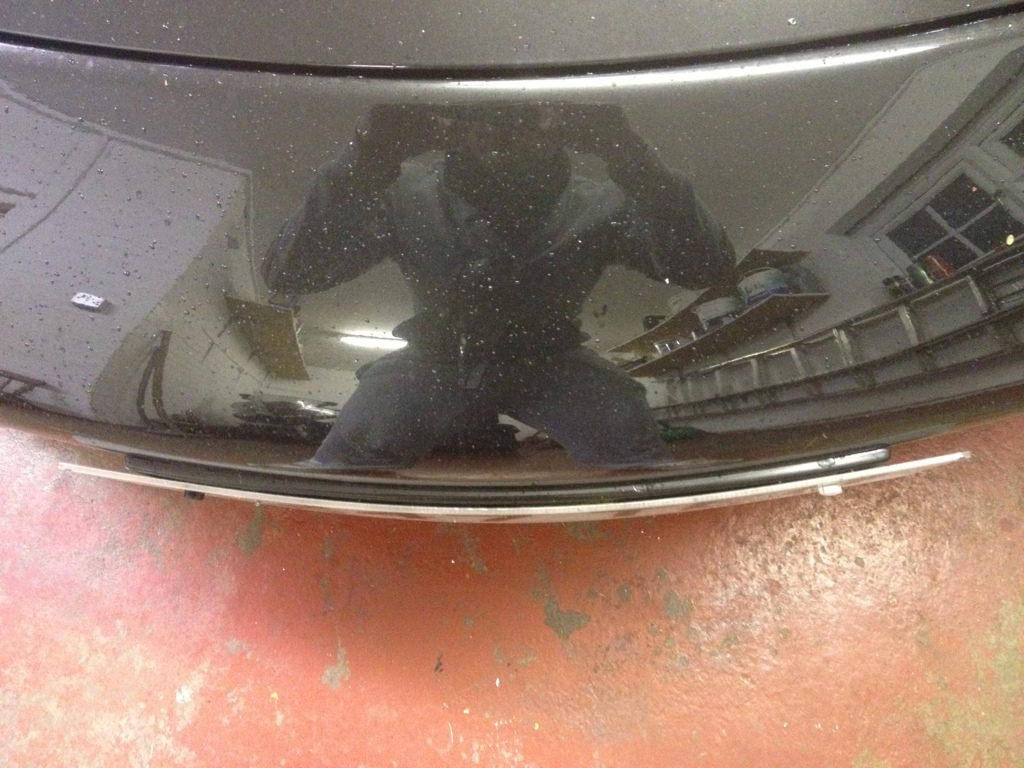

My car looks like this when looking from above
You can see the mounting plate behind the front licence plate

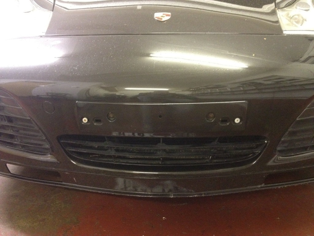

Removing the licence plate reveals the mounting bracket

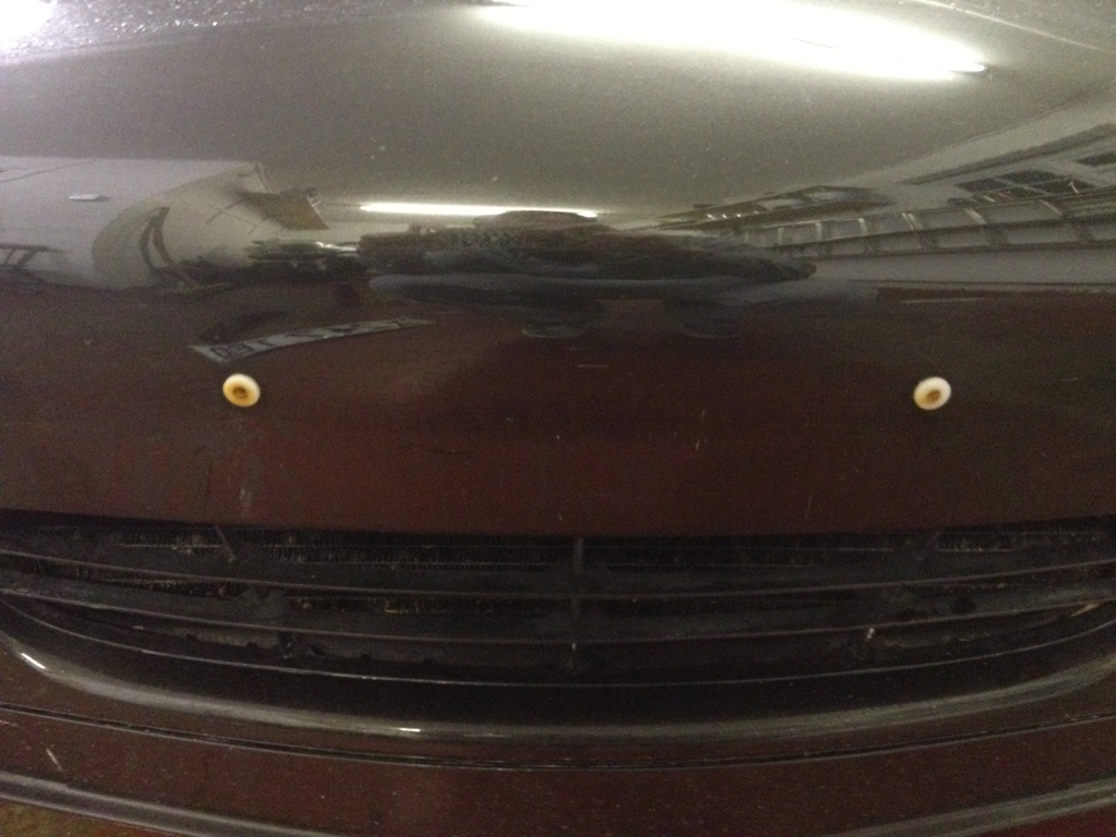

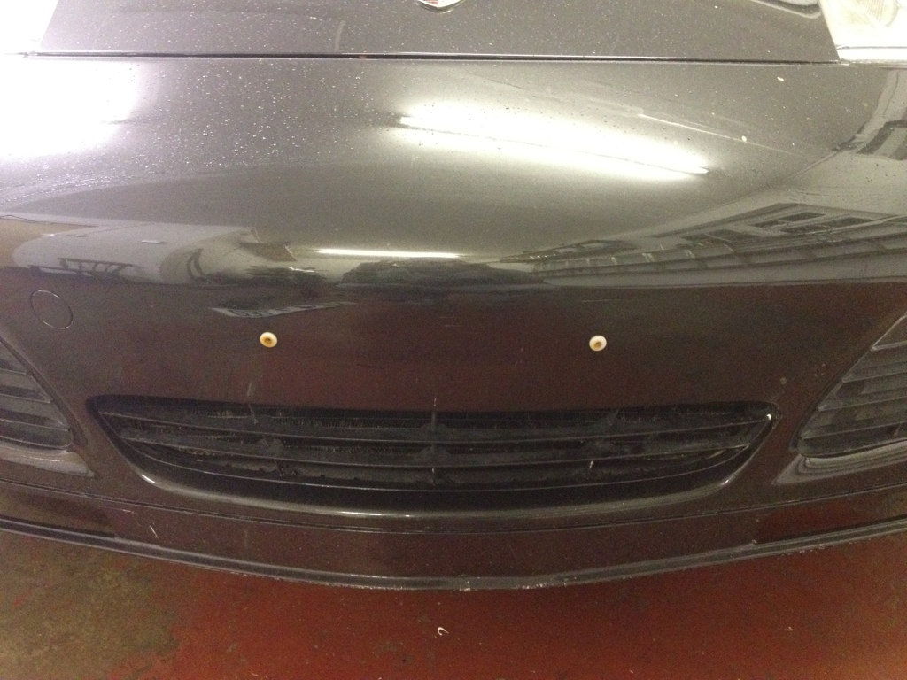

Removing the bracket reveals the holes in the bumper

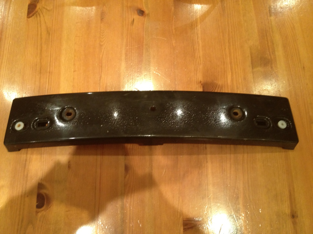

The front side of the bracket looks like this

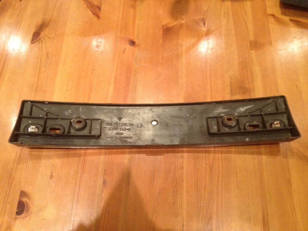

The rear side of the bracket looks like this

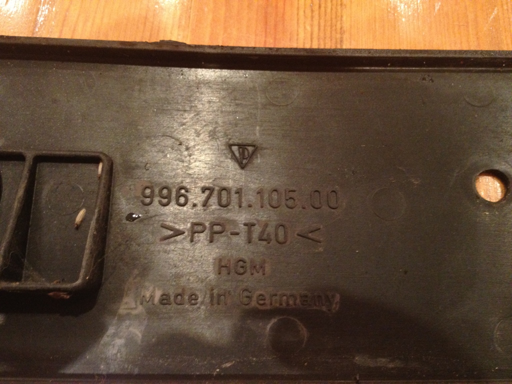

And here's the part number you need

Thank you ant_8u for taking time take it apart and the providing great pictures. Much appreciate!

You're more than welcome
Make sure you get the white plugs too - I don't know if they come with the bracket or if you need to buy them separately
There are four in total

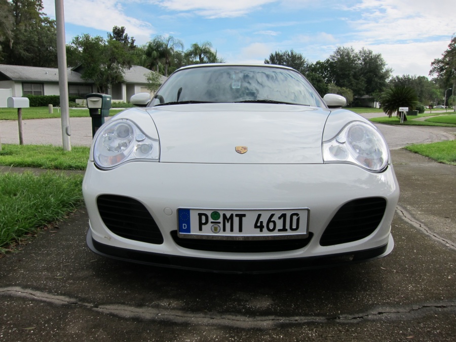

Mission accomplished! Thank you ant_8u and DYL_911!

Does anyone know what the white screws are, how they are held firmly in the bumper, and where you get them?

Threaded delrin or plastic screw inserts, McMaster Carr. Can't find the part #, but I'm guessing these are not so unique, ie HomeDepot, etc.
