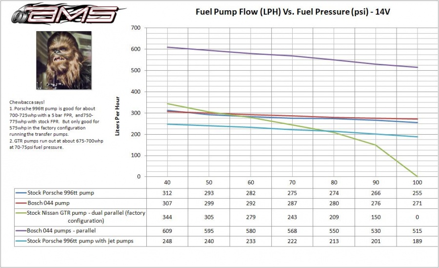

Is this pump a direct fit into a 2002 996TT fuel assembly? Any modifications necessary to fit? Is this a better choice than a GT2 fuel pump and assembly? Can it be used by itself without a back up pump? Anybody know the different outputs of the stock turbo pump, the GT2 pump, and the 044 pump? Any other info would be greatly appreciated.
https://www.6speedonline.com/forums/...-upgraded.html

I needed another pump,the 044 in line,to maintain a safe duty cycle with my injectors at my HP level..
John from speed Tech also runs an extra in line 044 pump with his K24/18 set-up.

One 044 that does not have to power the porsche in tank Jet pumps will easily push enough fuel for over 700 Hp with 72lb injectors. I would not want a 5 bar FPR unless really needed.
I feel the best way to go about it is to ditch the sock in tank set up for a single inline 044. It is fed by two bulkhead fittings right from each sump of the tank. -10 feed from each sump Y's into one line to a -12 filter then to the pump then to the cars rails with a -6 after the pump.
If you want to know how to go about setting this all up contact me via PM.
Meh.. people are to afraid to do that. I did that years ago. You are right. I did one pump for each sump independent lines to rails and one fpr. I do believe you can only push 72 psi out of a 044 pump unless its inline with another pump

Would love to see a solution with a single in-tank that helps to get fuel for roughly 650 whp.
what about that jet pumps? any idea to find a solution that do not drain power from that pump too much? are jet pumps and catch tank differ greatly from TT and GT2?

Why in tank. Like I said you drill a hole into each leg with a bulkhead fitting; go with a 2 into one Y to feed the pump with a coarse pre filter. The pump in mounted in the driveshaft tunnel. Because it does not feed the in tank jet pumps it is good for over 700hp. But the biggest issue with this system is a 044 is a noisey pump.
