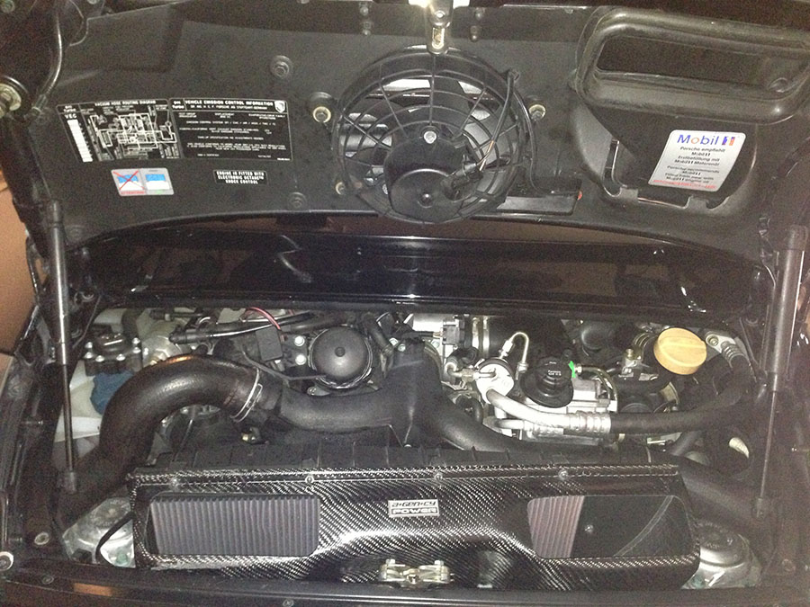

3) Obviously the AP dual snorkel box has two holes. The hole on the left isn't connecting to a "snorkel". Is this normal?
Don't know exactly what this one is, but I'll bet it's a Sportec knock-off...in any case if it doesn't have the extra opening in the "bracket" it isn't working (it might be bringing hot air into the system....bad idea). See pic of upper snorkel:
Thanks for the pic. I certainly don't have that extra snorkel on the left. Check out the image of what I have going on. Where would I pick one of those up?

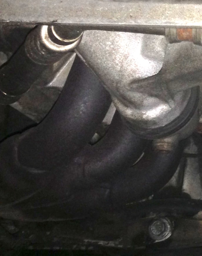

Here's a picture of the headers. Are they OEM?
Thanks for all the help!

besides the air cleaner housing ( looks like AP) everything appears to be stock OEM.
Attachment 192200
you have the a/p airbox . there should be a left side snorkel to go with the box. you cut thru the plastic panel to allow the air to flow thru. try vivid and see if they will sell you the snorkel separete. if not ill have a oem snorkel that can be modified to fit in the same place . 10 to 12 weeks backorder.
Thanks Krazy. I'll certainly give Vivid a call. Do you know the cost to have an oem snorkel modified?
I'm pretty good with fiberglass. Is there anything special that needs to be done, or it just as simple as the one of the right?
Thanks,
Michael
theres a thread or two on here. basically you trim the inside of the existing plastic panel and then glass the left side snorkel to it. in your case you already have the airbox opened up so that would be about it
some used jb weld for the snorkel but if i did it i would glass it and sand and paint to match. just be careful closing the lid so you dont crack it (snorkel)
