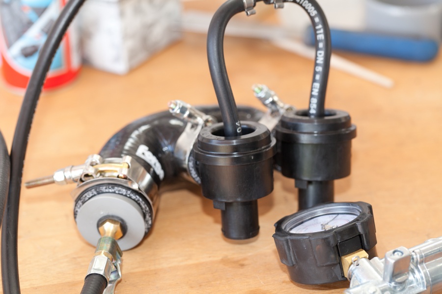

I built myself a test rig and made some tests. A f-hose was used to mount two diverter valves and the input was plugged in order to being able to pressurize it. The output of the diverter valves vent to atmosphere.
I have attached a picture of that test rig.
These are the control pressure rates and the resulting capability of the stock diverter valves to hold against a boost pressure:

This test was done to see what the relation between control pressure and the resulting boost pressure is. One could provide manifold independent control pressure in order to shut down the valves very quickly and keep them shut firm without playing with different springs (an option that not all diverter valves do support). This is something I have planned to do, but had no time yet.
So, why did I do al this? My nice and shiny FVD diverter valves have leaked and after looking at how they are built I decided to used the stock ones instead and made sure that they operate as they should.

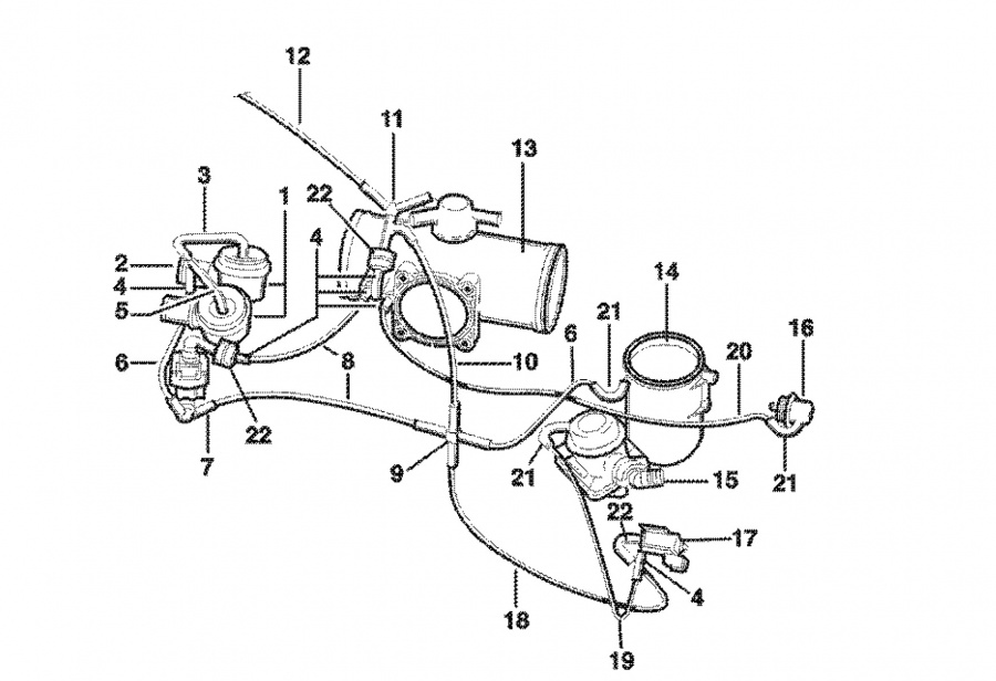

I wonder if that help?

jpflip, thank you for your image.

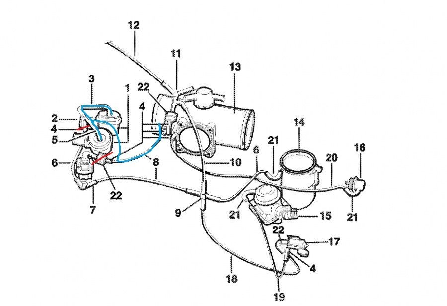

Originally Posted by GeeTee2
Just a question there, is there any interest to disconnect and unplug the top change-over valve piping ?
I found mine disconnected and plugged away, on purpose.
It could be that the last owner bypassed the N249 valve and has the diverter valves connected directly to the intake manifold boost/vacuum source.
So basically they would have removed the check valve and connected that hose to the hose that splits and goes to the top of the diverter valves.
Kind of like this where the red lines represent where the hose is disconnected/plugged and the blue lines are the new flow path directly from the intake manifold to the diverter valves circumventing the N249 valve.
