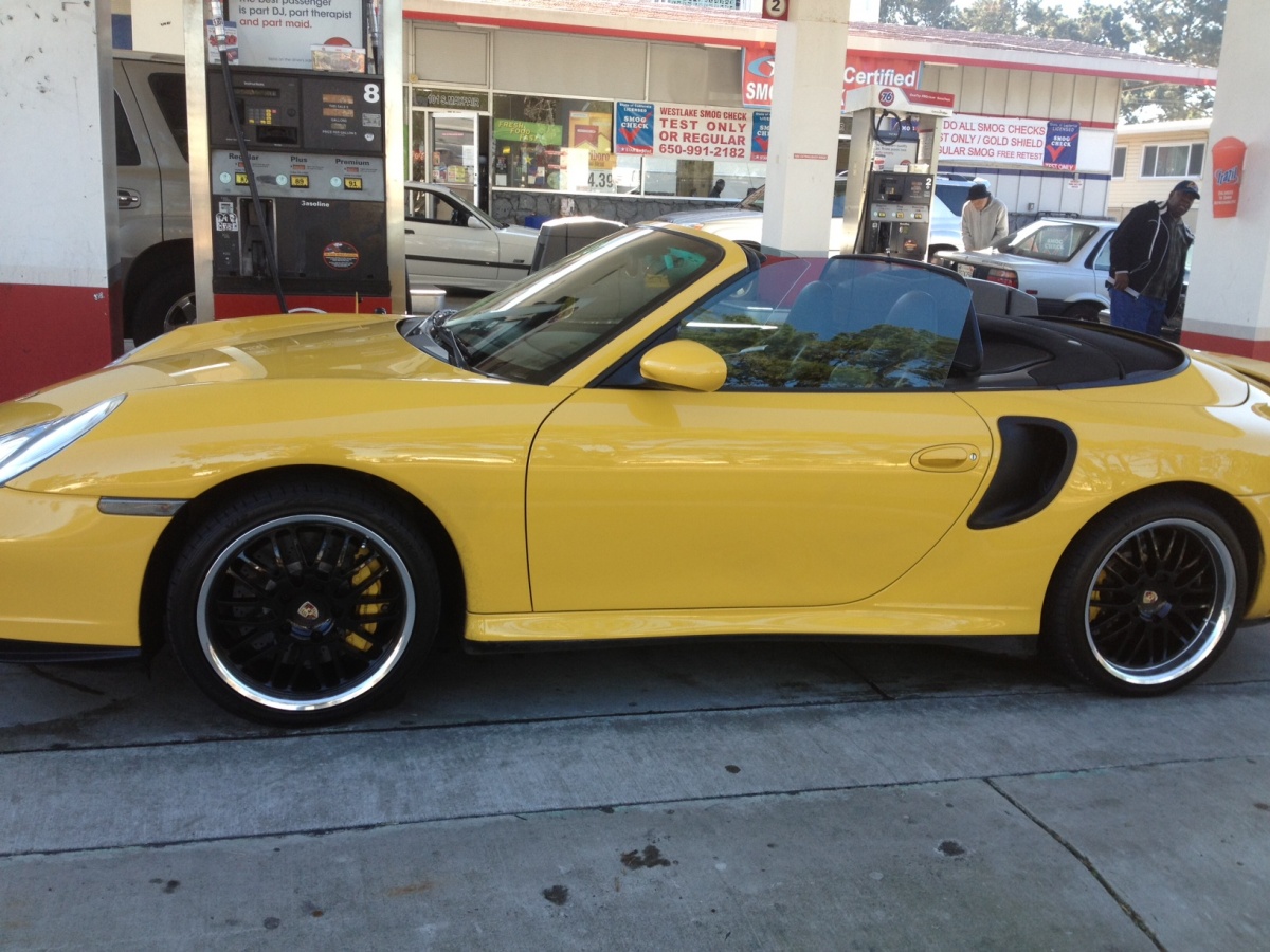

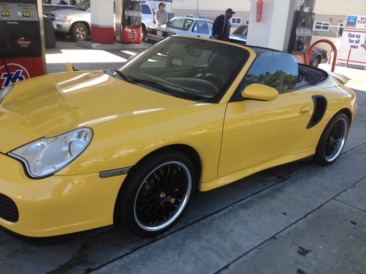

OK, I got the wheels installed with my existing rubber. I really like these wheels on this car and color combination.
The turbo vent is still plasti-dipped matte black. I thought that turned our OK.
I started out with the Sport Techno Turbo Twists in silver, and then I plasti-dipped them. It looked good and told me that I wanted black wheels. I like the polished rims.
All totaled, it was about $1800 for the rims + remounting wheels + alignment.
