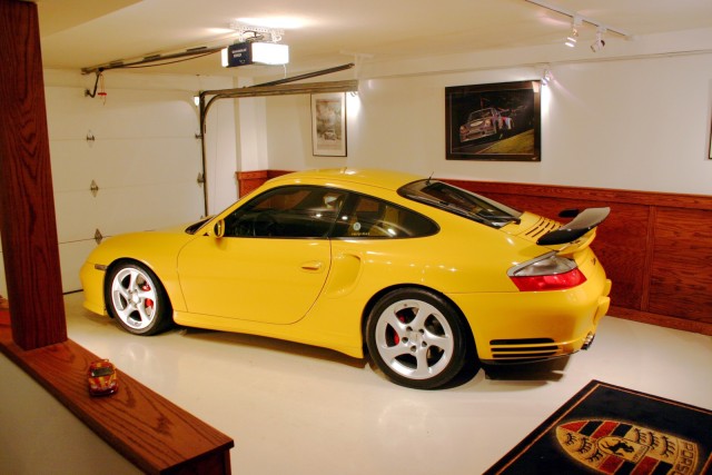

Yes, really. Here's a picture of my barn...
I had the same issue one other year, but caught the action in the spare tire area when I went for the jack one day, so I caught it early. I live in the country, much different than the city for mice...
That's a good lookin barn IF you're in the country there's almost nothing you can do about mice, they are just there.
Did you get it fixed?

Wow! I love your place John. Very clean and the car is beautiful....
