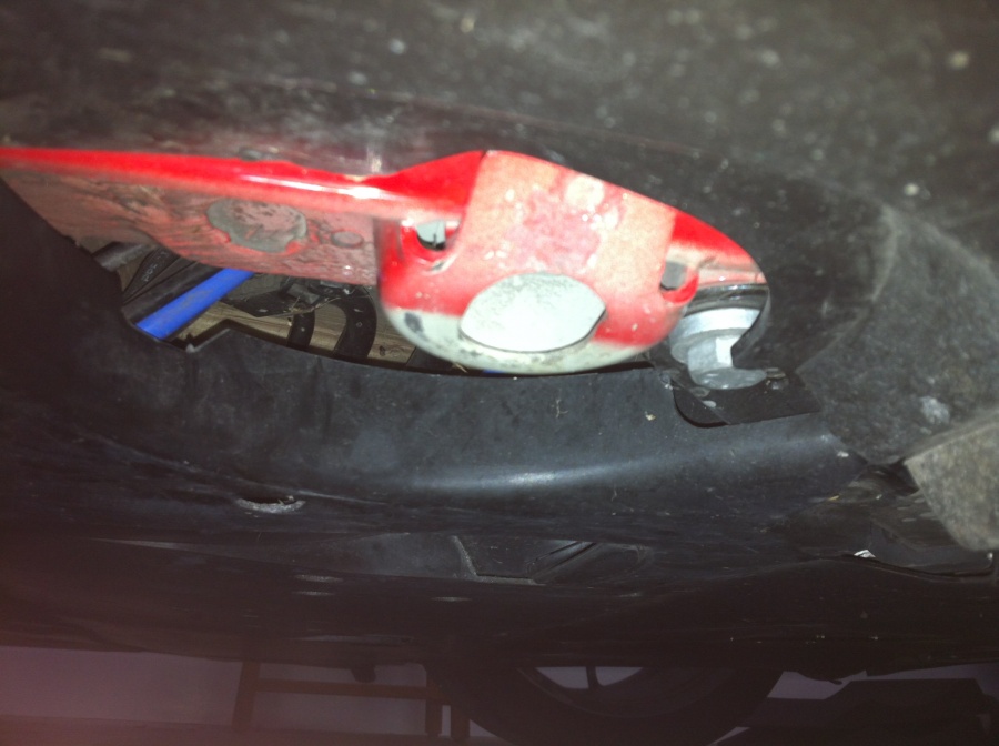

i use hockey pucks to ensure i clear the side skirts when i use my lift. for that price it seems like a decent deal.
oops that price was for 1! you can get 4 hockey pucks for under 20$ shipped and they work fine

I use something similar. I find that it prevents the claws on some lifts from gouging into the plastic trim of the side skirts. The plastic insert prevents the disc from shifting positions during the lift. Otherwise the hockey puck works too.

what i found with the jackstands were grind down the teeth, use a small metal plate and drill and tap thru the stand then drill the hockey puck and bolt it all together. this way it cant slip off

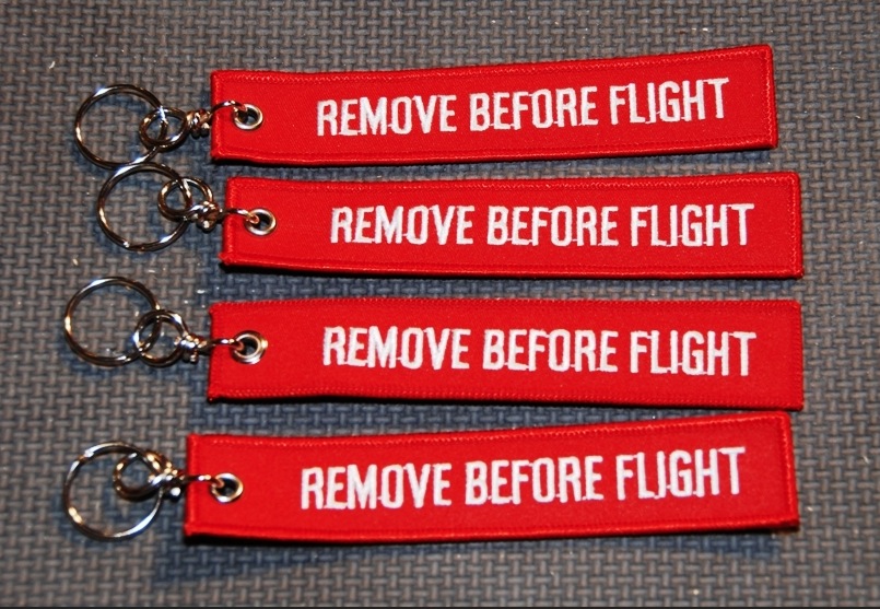

I use exactly the same type of jackpads and I put flags on them to prevent driving away with them attach to the car...... Yes I did......
Little bit cheaper but work like a charm....http://www.ebay.com/itm/PORSCHE-JACK...item337880f10a

Both.
When a puck slides to the lateral edge, it can actually shift the weight support and bend then jack point.

Got to order the "Remove Before Flight" ribbons
still lost
