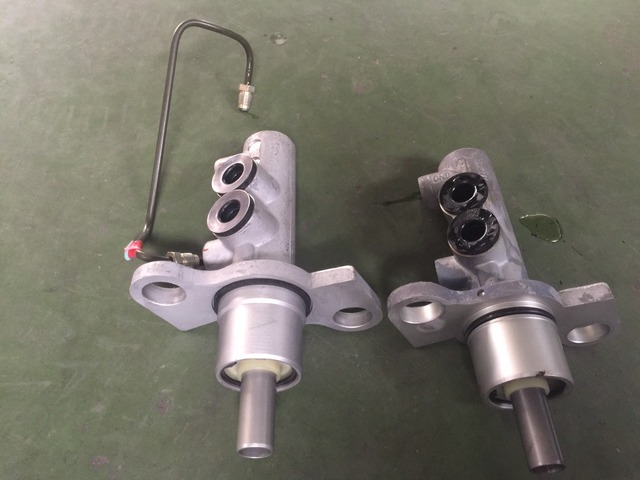

I just add 996 GT2 380mm steel front rotors with 997 GT3 Brake Master Cylinder, But something just happened...engine check!! seems the floor is too strong, please help ! how to do next....
And for comparing here is 996TT stock brake master and 997 GT3..seems GT3 brake master is bigger, I have to use adapter to install on it..

When the smart folks chime in I'm looking for the hard line adapter for the M/C also
pwderhound has them. i bought one a yr ago and tucked away just in case....

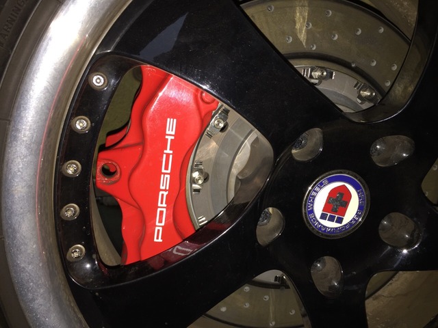

Why changing the master brake cylinder? Im am running 380 mm ceramic discs and 6-piston-calipers on the front and 350/4 on the the rear, just like the full big ceramic package of the 997.1 turbo on my 996 turbo.
The 996 master brake cylinder just works fine. Before it had to feed 4 larger pistons and now 6 smaller ones. You won't notice the difference in the pedal.
The difference of that brake on a lighter car you will notice for sure

Pics of 997.1 ceramic brake on a 996. The car is a bit lower now as it was at that time:
