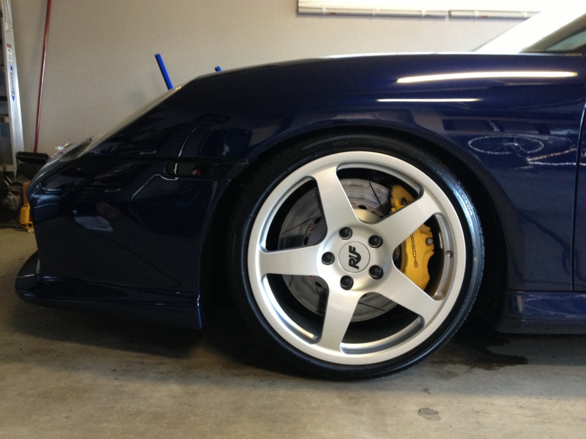

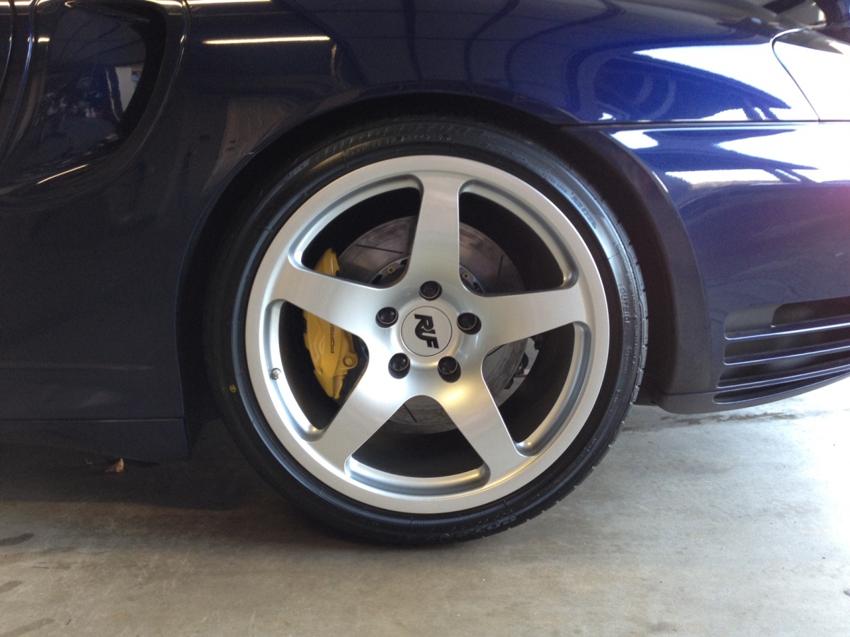

Do not waste your time. You need the calipers that are used on the 997 PCCB TT or GT2/3 PCCB cars. I used to run the 996GT3 six pots with 350f/350r rotors. I have explored the option of going to 380s while spacing out the calipers but it can NOT be done using the 997TT(with steel)/996GT3 6 pot calipers (w/ 146mm bolt spacing) due to their offset mounting design. This caliper will not space out radially. As you try to space it out it will impact the rotor at the calipers bottom edge. It's hard to explain without actually trying it.
I ended up having my 996TT based car converted to 380mm front and 350mm rear steel floating rotors but the only way to do this is to use the 997.2 PCCB calipers (225mm bolt spacing) that are used on the 997TT with PCCB or the 997GT2/3 with PCCB. These are designed for use with 380mm front and 350mm rear rotors. The front 997TT or 997GT3 PCCB calipers are visually the same but the piston area is about 10% smaller on the GT3 calipers which will give you a touch more rear bias and a slightly harder pedal. I have both the GT3 and TT versions but have not compared one to the other yet. When you do this conversion, you will need to upgrade the brake master to the 997GT3 27mm version to firm up the brake pedal as you will be pushing more fluid due to the larger 34mmx2 rear piston calipers. It goes without saying that you will need to upgrade the rear calipers to the larger 997TT/GT3 units with 350 rotors other wise your brake bias would be totally wrong.
I tested this brake set up at the track last weekend and it is phenomenal as far as heat dissipation goes. The greater rear bias from the larger rear calipers works extremely well and with the larger 997GT3 master your brake pedal is rock hard. This system is far superior to the 996 GT3 six pot 350/350 set up that I ran before. It does not necessarily brake any better than the 996GT3 350mm set up, or the stock TT 4 pot 330mm set up for that matter, but it does provide HUGELY better thermal dissipation when you hammer the car at the track for extended periods and it does shift the brake bias to the rear which does help braking performance a bit compared to the 996 system. I do have all the GT3 cup cooling ducts on my car which further helps with cooling. The one thing you will need to be careful of is the selection of wheels if you run the 380mm set up as only a hand full of 18" wheels will clear those brakes. My track 18x9 front wheel will clear the 380 calipers with about 3/16" to spare but they are manufactured to work with the 380 set up. The silver 5 spoke wheels are 19x9/12 and the grey track wheels are 18x9/12 in the pics below. Hope that helps.
Name:	997.2 PCCB 380 Brakes.jpg
ID:	223582   Click image for larger version
Name:	997.2 PCCB brakes rear.jpg
ID:	223583   Click image for larger version
Name:	CCW 18x9 w: 380mm PCCB.jpg
