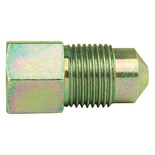

Ok, I'm lost here. Below is the link to the Autozone M12 bubble male adapter that crews into the Master cylinder? Is this what you are modifying and why since it screws fully into the Master and engages without a problem? The male portion is a M12x1.0 bubble and the female is 3/8-24 inverted.
http://www.autozone.com/autozone/acc...er=183672_0_0_
M12x1.0 bubble to 3:8-24 inverted by pwdrhound1, on Flickr
Are you talking about having to sand or modify the autozone M12 adapter that actually threads into the Master cylinder OR are you talking about having to modify the 3/8-24 tube nut that is used on the 3/16 (4.75mm) brake line that threads into the female inverted flare portion of the adapter (that is threaded into the Master)? I assume you fabricated a new line with a M10x1.0 bubble fitting on one end (the one that screws into the PSM pump) and a 3/8-24 inverted double flare fitting on the other end that screws into the Autozone adapter that is on the Master? However you state that you made a line with inverted flare fittings on both ends which would require you to also use an adapter on the PSM pump also since that is set up for a M10x1.0 bubble fitting. Confused....

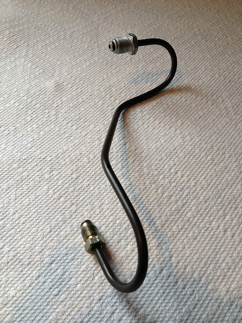

I made a new line that has a 10mm and 12mm fitting on it. The 12 goes into the master cylinder in the rear port and the other 10mm end goes into the ABS pre-pump. As far as I know, I went through every option with Suncoast in trying to find a compatible brake line that would simply plug in - no such luck.
The adapter you that was shown earlier was the exact same one I used and another poster used and had to modify it - I decided not to go this route. The cone shaped end of the adapter is too long in order for the threads to engage in the master cylinder female threaded opening (12mm), and
Ok, gotcha. So you bought a 3/16 (4.75mm) same size as OEM brake line and put a M10x1.0 bubble flare nut on one side and a M12x1.0 bubble flare nut on the other side. I assume there were no issues with the small 3/16 line bubble flare sealing properly on the larger M12 outlet port on the brake master? The reason I ask is that normally the larger 1/4" brake line that is used with the larger M12 port (as is used on the front M12 port of the brake master) creates a much larger bubble flare with a greater sealing surface.
Also, what tool did you use to make the good bubble flare on your new line? A well make flare is critical for a good seal as you know.

A simple double flare tool from Autozone will do the trick - it is how you actually make it. most of my tools are purchased from either Mac or Snap-On for my shop. However, i had this flare tool from a long time ago and was going to purchase one from the Snap-On truck the other day. Honestly, it looks no different in quality or design than the Autozone tool.
My lines are very tight and no leaks. I also replaced my brake booster while I was in there.

So after a lot of hair pulling I finally bought a professional brake line flaring tool which made making OEM quality bubble flares very simple and easy. I tried the simple flaring tools available at Autozone and other auto parts places but was not happy with the quality of the flares created by these tools. I ended up making a brake line with a 10mm nut on one end and a 12mm nut on the master cylinder end. I used a tubing bender and the result was a line on par with the quality of the OEM brake line. FYI, as was suggested in a previous post, using a 12mm/AN along with a 10mm/AN fitting adapter and connecting to a braided steel brake line will not work as the 12mm portion of the 12mm/AN adapter is not deep enough to engage and seal the base of the brake master port. I looked at all the options and making a new line is really the only way to go.
Brake line 12mm:10mm by pwdrhound1, on Flickr
12mm brake line by pwdrhound1, on Flickr
12mm 997master brake line by pwdrhound1, on Flickr
