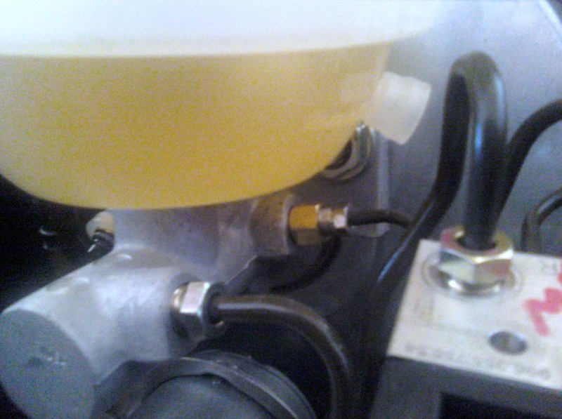

yes heres a pic , mine all finished with 27mm

I see you needed a adapter for the rear line.

yes i've actually driven it a few months now, no issues and pedal feel a lot firmer and less travel..all in all a very good swap imho
yes you must use the adapter as the later 27mm cylinder has the larger thread both front and rear, got mine at autozone, you could also get a shop to make a hardline with the correct fitting sizes as well
