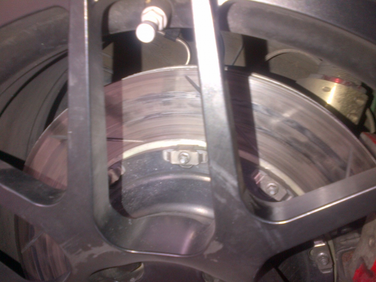

contigo has a brilliant futurecontigo has a brilliant futurecontigo has a brilliant futurecontigo has a brilliant futurecontigo has a brilliant futurecontigo has a brilliant futurecontigo has a brilliant futurecontigo has a brilliant futurecontigo has a brilliant futurecontigo has a brilliant futurecontigo has a brilliant future
Front discs not even brake pad fade, must be one of the pumps, which ? PSM o ABS?
