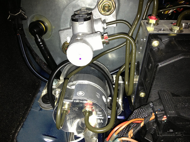

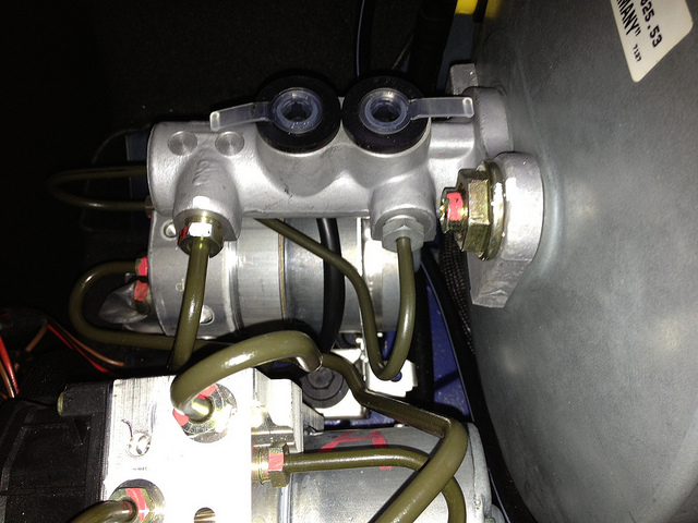

The 997GT3 Brake Master swap is fairly straight forward. Place a bunch of paper towels under the reservoir so you do not spill fluid anywhere and then have a mess to clean up. Brake fluid is corrosive and will eat paint! You need to empty the fluid out of your brake fluid reservoir. I just used my motive bleeder to pressurize and drive the fluid out by bleeding out one of the calipers. Once empty, disconnect the plastic line that plugs into the pre-charge PSM pump under the brake master. To disconnect, push in the plastic collar on the line at the PSM pump, then pull on the plastic pipe and it should slide out easily. Do not force it! Next step is to pull straight up on the empty brake fluid reservoir and it will pop out of the brake master. Gently wiggle it side to side as you pull up and it will eventually pop out out of the rubber grommets.
Next, remove the big nuts on the brake booster (24mm I think) and the brake master will slide out. Installing the new master is the reverse. Just make sure the brake push rod properly engages the input shaft on the new master as you install it.

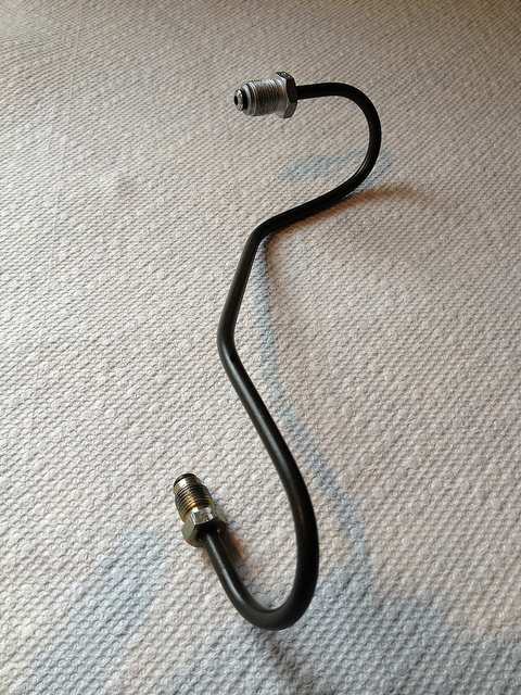

The biggest pain in the installation was the fabrication of the 12mm/10mm line. I went through the adapter route which was not really optimal and even had a local brake shop make me a new line with custom flare. The tool they used was the $50 cheapie flaring tool and the line ended up leaking. It was not until I purchased a professional brake flaring tool that I was able to make a professional OEM quality line that was to my satisfaction. Finally, after everything is installed, and prior to filling the reservoir with fluid, I would recommend pressurizing the whole system to check for any leaks. I did this by connecting my Motive bleeder, pressurizing the empty brake fluid reservoir to 25psi, and left it connected overnight to make sure everything held tight. It's a lot better to find out if you have a leak somewhere prior to having a reservoir full of fluid and creating a mess. Hope that helps...

So after a lot of hair pulling I finally bought a professional brake line flaring tool which made making OEM quality bubble flares very simple and easy. I tried the simple flaring tools available at Autozone and other auto parts places but was not happy with the quality of the flares created by these tools. I ended up making a brake line with a 10mm nut on one end and a 12mm nut on the master cylinder end. I used a tubing bender and the result was a line on par with the quality of the OEM brake line. FYI, as was suggested in a previous post, using a 12mm/AN along with a 10mm/AN fitting adapter and connecting to a braided steel brake line will not work as the 12mm portion of the 12mm/AN adapter is not deep enough to engage and seal the base of the brake master port. I looked at all the options and making a new line is really the only way to go.
Brake line 12mm:10mm by pwdrhound1, on Flickr
12mm brake line by pwdrhound1, on Flickr
12mm 997master brake line by pwdrhound1, on Flickr

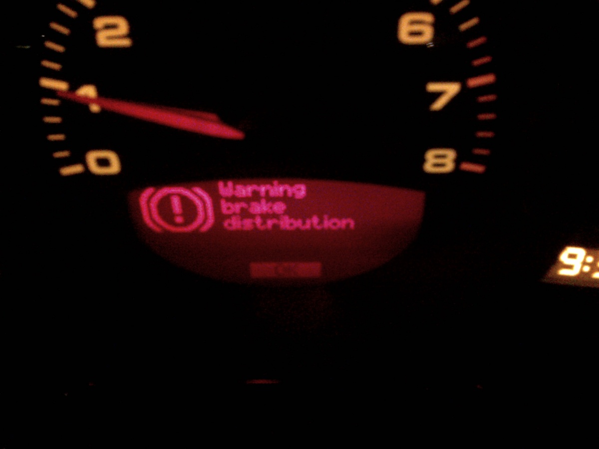

Installed and trouble
Got this after the install, feels like car brakes better in front .
Didnt have any issues like this before.

Comments please and help.
I have front Brembo 8 piston and rear 997TT rear brakes.
Attachment 223702
Attachment 223703
Have no idea. That's why I hate using mix and matched aftermarket parts. I have no clue what the piston area is of the Brembos but I would probably use the Brembo brakes in the rear as matched set. Why did you use the Brembos instead of the Porsche/Brembo calipers? There is absolutely no issue with those. Good luck...

I just changed the cylinder now and never had an issue with that setup with the oem cilinder, that was the only thing I changed.
I have no idea then. The larger master is a proven swap on these cars. The larger master just moves more fluid both front and rear. I'd say something else is at play here. Hope you get it sorted...
