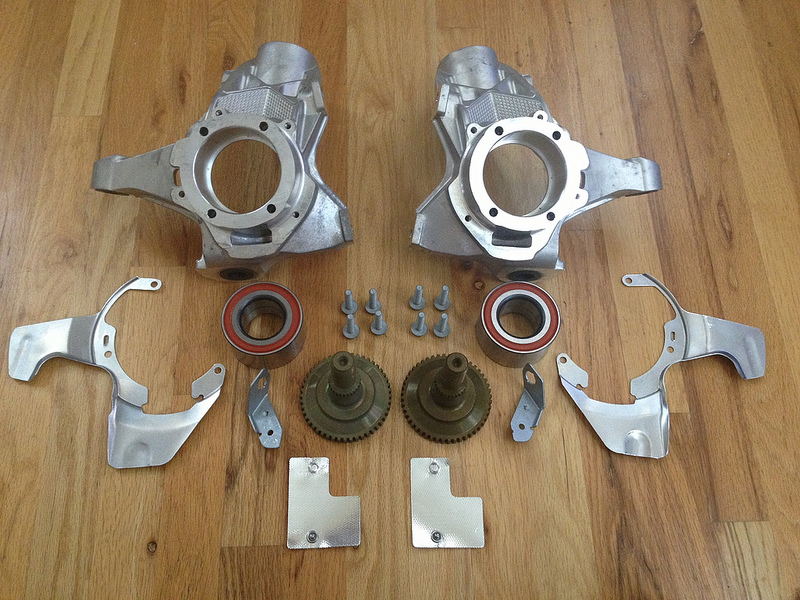

Old Jun 8, 2014 | 10:25 PM
  #65
pwdrhound's Avatar
Joined: Jul 2010
Posts: 4,848
Rep Power: 457
Originally Posted by Whereitsat
Powderhound, do you have a parts list do what you said above? I want to maintain my or shocks and H&R springs for know, but want to get more toe and camber and drop the front diff. Thank you.
In order to run the GT2 uprights you will need coil overs. You could probably find a cheap set of GT2 coil overs that someone has replaced with Motons, JRZs or other shocks. The uprights are not compatible with the stock TT shocks. If you want more camber then you need to get GT3 LCAs or Cup LCAs. Both will allow you to get more camber via the use of shims. Here is what you need for the upright conversion. The only thing not shown are the upper shock mounts. I would have to dig up the part numbers but any Porsche dealer can pull them for you..
[url=https://flic.kr/p/fzqFcw]
