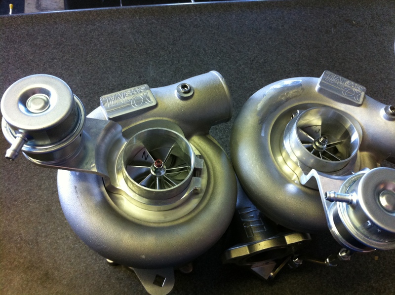

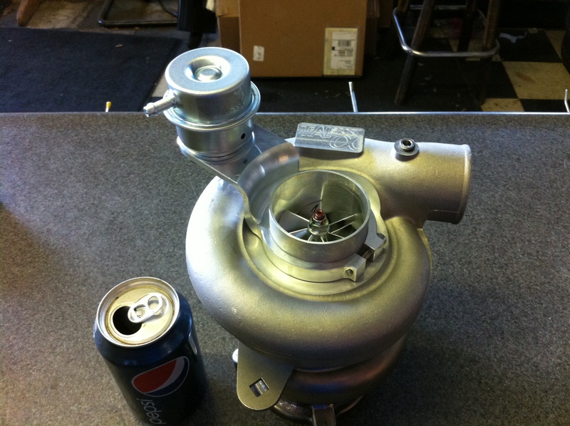

So after killing my passenger side turbo a few weeks ago, I put in an order. Well, the turbos just showed up. TIAL Alpha 3076 goodness.
Waiting on some more upgrades parts to show up from Protomotive, then on with the tuning. We will be holding back some due to stock rods, and maximize what we can with it. Eventually doing rods and some other upgrades, but limited for now. It won't be as impressive as many of the cars on here, but it should keep me smiling for awhile. Just thought I'd share!

nice improvement! Are they internally gated or just mounted that way? Post up numbers when you can.

Holy ****, I've never seen them with a size comparison. Those are huge!

before you put them on do two important things... 1. check the wWG setting on both turbos and make sure they are where you want them... and 2. make the hotside housing backplate bolts are tight.... seen 2 sets now that backed out and one actually lost one back plate...
good luck

Thank you. Internally I believe. Im not too turbo savvy, but thats how it seems to me. N local AWD dyno around, so first thing up will be 60-130 numbers. my best on my previous turbos is 7.39 on 91 octane

I hadn't either, which is why i took a picture that way. They are bigger than I thought, but that gives me some good hope!

Thanks Markski. Planning on the good old Mighty-Vac pressure test to check WG springs. sound good? Im not sure where I want them at, just that they are equal. So I will converse with Todd to see what he suggests. I will also be sure to double check the... hotside backplate bolts? is that on the turbo, or where the turbo bolts to exhaust?
