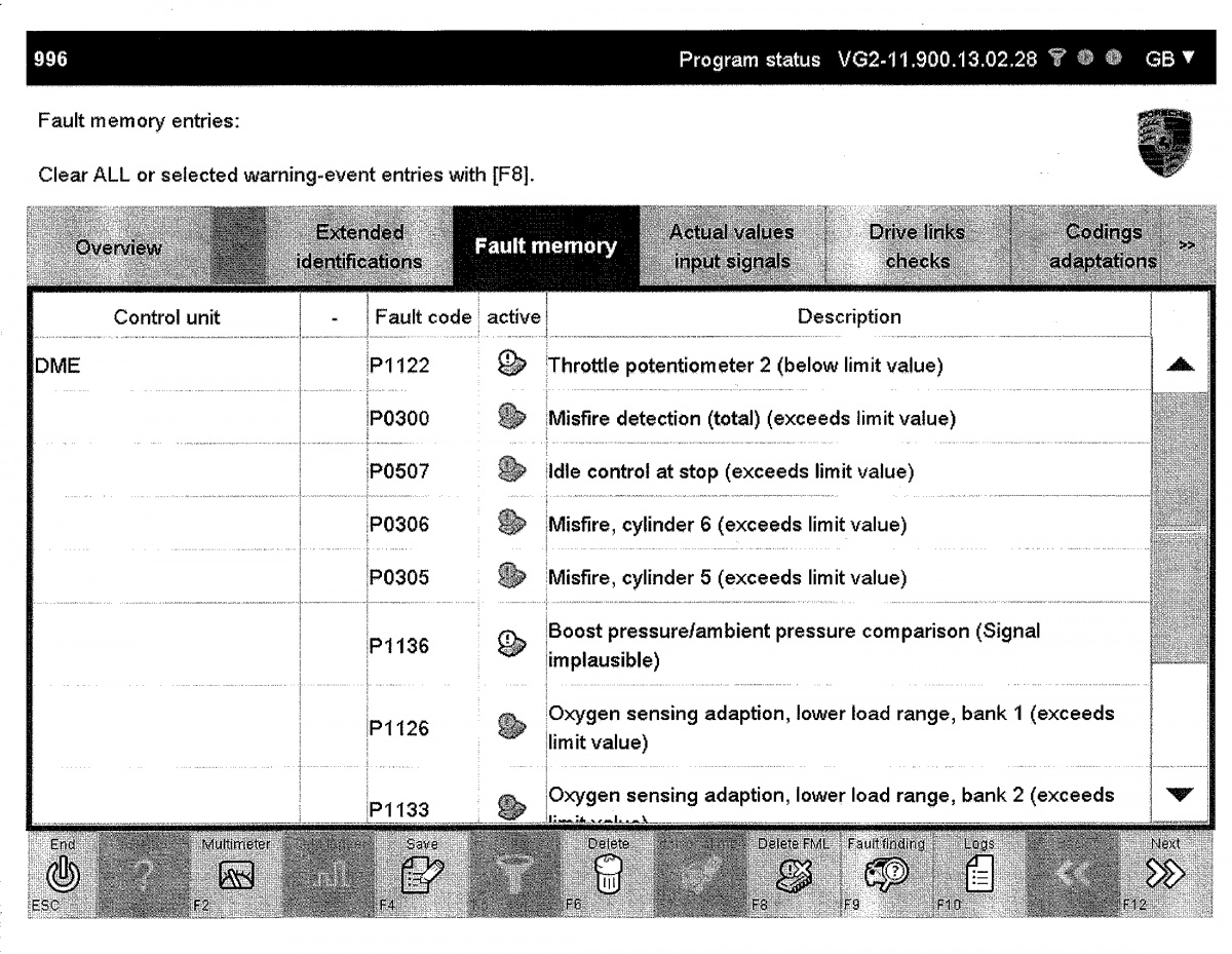

Ok, so after I changed out the coil packs and spark plugs in hopes of resolving the misfire issue and to no avail...I took it in to the dealer to have them run some diagnostics on it. Error codes are attached.
They did a vacuum test/smoke test, checked the MAF and checked out something with the throttle. All of those were good. I also had them check out a small oil leak that's been going on since around the same time that the misfire issue came out. They said the oil leak is coming from the bottom back side of the oil filter housing. They also said that there is a small transmission leak and it needs resealed. They are telling me the engine has to be dropped to get to the oil leak, so they quoted me around $4K for the repairs. They still have no idea about the misfires.
Not sure what to do at this point. I went ahead and picked the car up. Considering dropping the engine myself this summer, but that will be quite the project as I've never done that before and I don't have all the tools I'll need. Also considering getting rid of the car after reading many others' horror stories about the misfires and huge repair costs.
Any thoughts or advice?

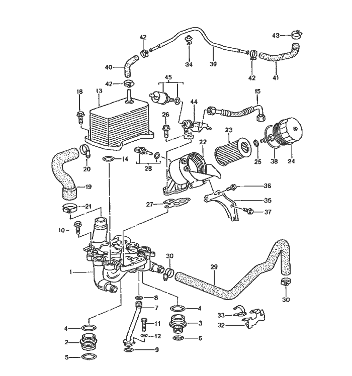

Likely the leak is from the oil pressure sender #45 in the below picture or the line #15 connecting it
Misfire could be bad fuel, when does it happen? All of the time under boost or part of the time. Looks like some of those other codes could be the problem as well.
No CEL but still having misfires?
Thanks for the diagram! Misfire happens under heavy boost pressure, usually above 4K rpm's. It's almost like it's hitting a rev limiter. I was going around 70 on the hwy, went WOT and the car would literally not go any faster or make any more power. However, if I ease into it with the throttle, it doesn't really have a problem with getting up to higher speeds around 90 or so. I haven't wanted to test it above 100 in fear of damaging something.

I'd recheck the codes in the computer, the dealer likely cleared the old ones so anything showing now will be relative to the issue.

According to the printout the dealer gave me, it's cyl 5 and 6. I used Bosch FR6 LCD plugs.
