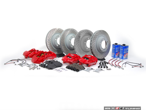

  • Porsche 996 GT3 six-piston calipers replace stock four-piston calipers for bigger bite when you need it most.
  • Larger 997TT rear calipers increase piston diameters from 30/28 to 34/34mm for better balance.
  • Both front and rear direct fit calipers are Porsche-made; bolting directly to the knuckles without the need for intermediate brackets. Hardware included.
  • Painted bright Porsche factory Guards Red, all calipers display handsomely behind open faced alloy wheels.
  • Hawk HPS pads improve bite cold and hot, with reduced pad wear. Their unique ferro-carbon friction material is rotor-friendly, and goes about its business with professional, unobtrusive authority.
  • German made Sebro single-piece 350mm front brake rotors, and OEM 350mm rear rotors increase total swept area. Their larger diameter moves the calipers outward for more braking leverage. Rotors are vented and cross-drilled for fast heat dissipation; added mass sinks heat away from pads, and resists deformation.
  • Kits come with all mounting hardware, including caliper bolts, retaining clips, stainless steel rotor screws, and pad wear sensors.
  • Bleed the system with the included Ate Super Blue DOT4 brake fluid, rated for higher wet and dry performance than DOT3.
