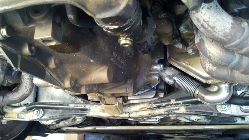

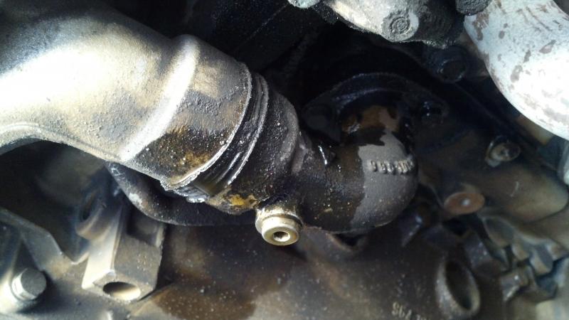

Also, I been looking at part diagrams and still can't figure out what that O-ring seal is apart of. What part is this?

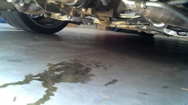

Noticed a small puddle of oil under my car a couple of days ago. First time I've ever had a leak with this car. After looking under the car I found what looks like a similar leak location to you guys. Any of you guys figure out what was leaking on your car? I haven't had a chance to do any investigation yet but figured I'd see if anybody has any good ideas. I'll follow some of the leads above but I'm pretty sure its not Pentosin. The fluid on the ground in my garage I'm pretty sure is motor oil and not Pentosin or coolant. That is what I gathered from the appearance (golden brown), smell, and touch unless Pentosin changes color when exposed since I know its green. Here are some pics

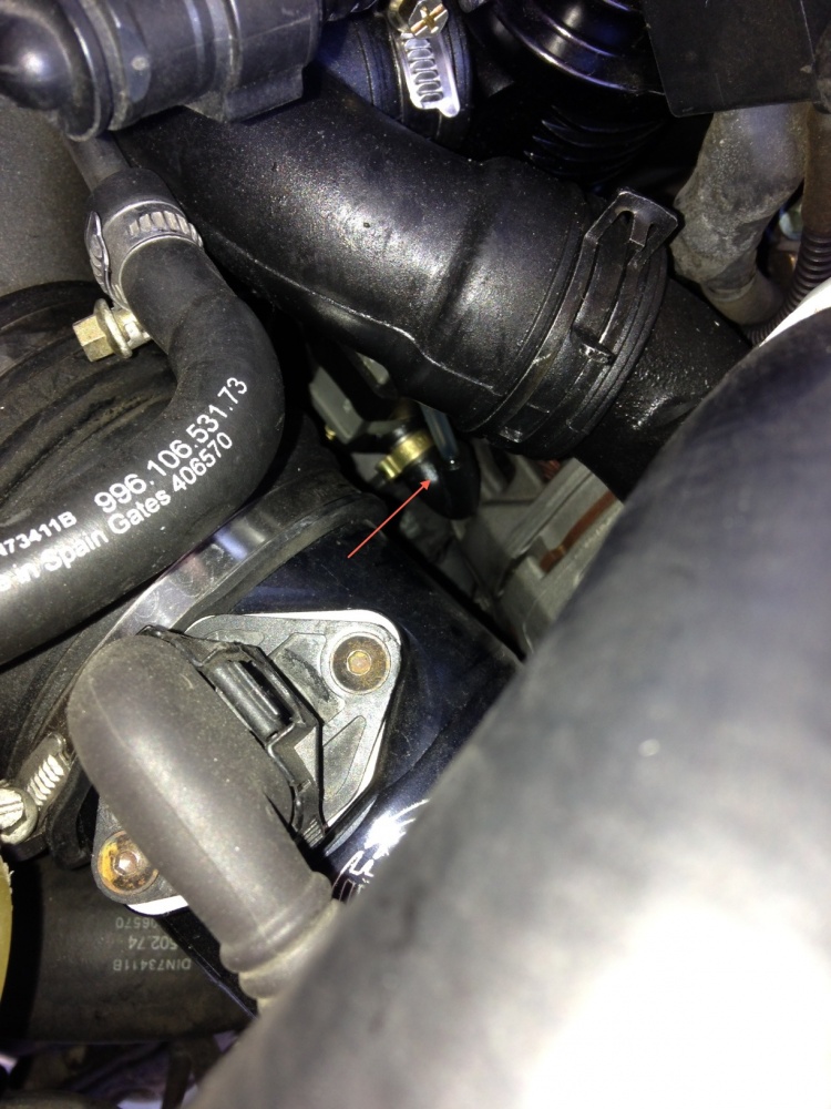

I been looking more into this leak, and found this hose weeping a little. What is this? (See picture, clear, small hose)
I also see fluid on hose 996.106.512.72...looks like a "water hose". Any suggestions as to what it can be? The fluid is either dirty Pentosin or oil. Hard to tell because it dirty. So stumped!

The small hose you are pointing is a sense line (no fluid in it) and it is connected to the change over valve which is used in the operation of the diverter valves.

Hmmm not sure why there is fluid on there. I can see it attached to the DVs but not sure why it is wet???

There 's not too many component over this valve that can leak any kind of fluid over the change over valve. You should clean it with a contact cleaner or any cleaner that dry completely without leaving any oil deposit and drive the car for a while and do another leak check later....Can it be a small oil splash while refilling the oil reservoir?

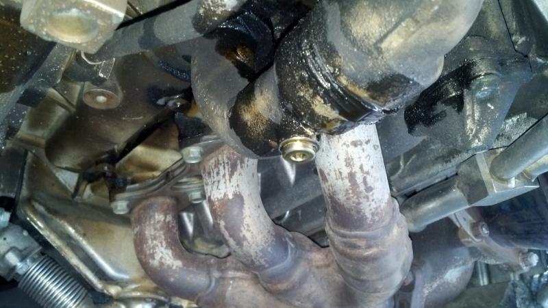

Got the car up this weekend so I could get under it and take a look at the leak. The leak I have I am pretty sure is not Pentosin doing a side by side smell test of the leak and smelling the dipstick on the power steering reservoir. It smells just like motor oil. From what I can tell it does not look like it is coming from above. The aforementioned oil lines from the turbos are dry. The most oil is gathered around the rear part of the passenger side exhaust header and at the area where the valve cover meets the head mostly on the rear portion. Either of these prone to leak on these cars? I've had valve cover gaskets leak on other cars (most recently on my Mitsubishi Eclipse). They are easy to replace on a front engine car with the heads sitting right up looking at you under the hood. If that is the source, it does not appear easy to replace on this car. I've since cleaned all the oil off and will go for a drive and see where the leak presents itself.
