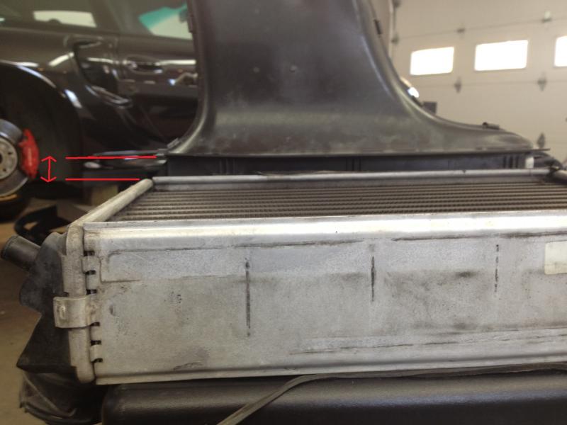

I tried following Earl's instructions but it doesn't work, the intercooler sits about 1/2" higher on the frame than the OEM intercooler. The top duct then become too tall and it won't fit without major prying and what this does is it creates a gap between the top portion of the duct and the duct on the car. The duct would need to be smaller or the intercooler would need to move down about 1/2 ". Here is a pic to show the height difference if they were both installed on the frame. Anyone can tell me what i do wrong?

I installed the 997.2ICs according to Earls instructions and everything was a perfect fit. The only thing different I did was extend the factory metal IC duct clips instead of using plastic zip ties. You can see in the pic below that everything seals up nicely.

This is the only picture I have. It's been over a year ago since I installed these and don't recall the details other than the fact that everything sealed up nicely including the top of the upper duct to the body of the car. I believe one of the IC tabs that hooks into the IC is not used with the 997.2s. Other than that it's pretty straight forward.

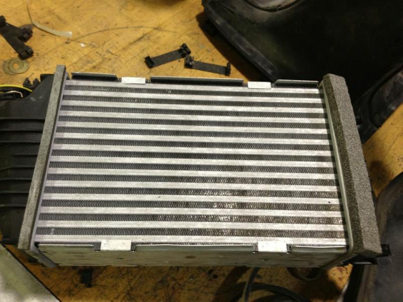

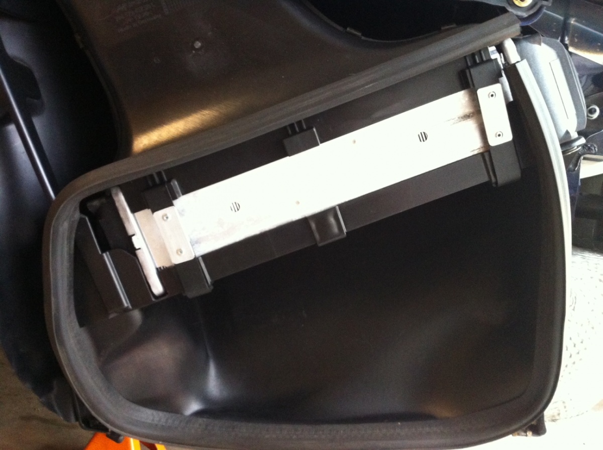

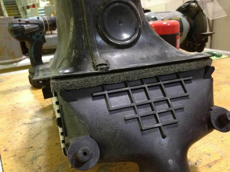

just wanted to upgrade my thread, i was able to install them, still had a little gap at the top of the duct but i installed new weather stripping and it should work. I did a couple of things different from the DIY of earl3 but the biggest was the aliminum plate which i didn't use. Instead i went and bought a very big weatherstripping, it goes up to an inch so it fills the gap plenty enough. Here are a couple of pictures.
