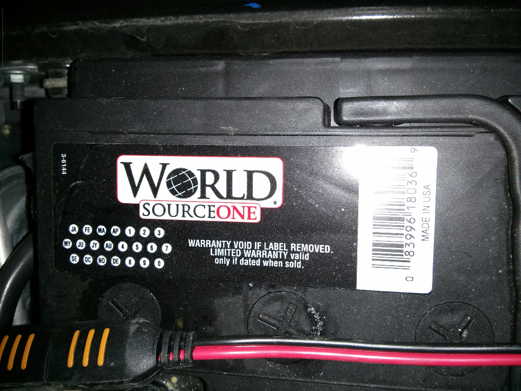

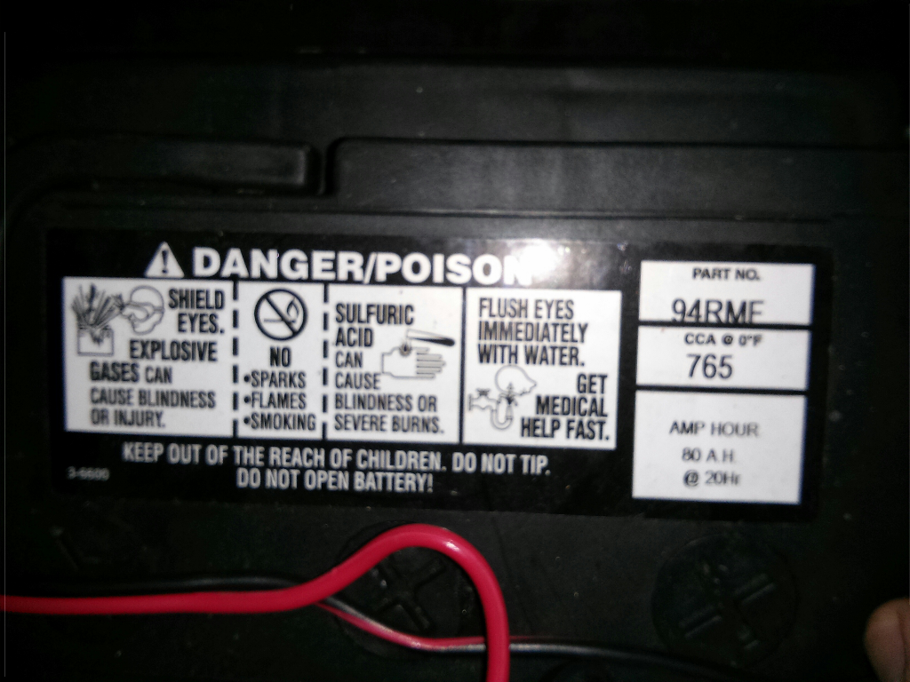

This is what's in there now. Anybody have any input to whether it's reliable or not?

BTW. The battery you have seems to be the wrong one for your car. Based on their website . Your battery should have a number starting with 48 ( if you have a 911 - C2 2001). The battery you have is for a Boxter S. ( 94R..) I am thinking you have a dud... Google is ALWAYS your best friend. This took me ohh about ..... 35 seconds to figure this out ... You may want to double check me. Cheers
What's the difference between Option 1 and Option 2 on the website? Because with 1, it gives me the 94R and with 2 it gives me the MTP-91 or the 48. I have a '01 3.6L Turbo.
