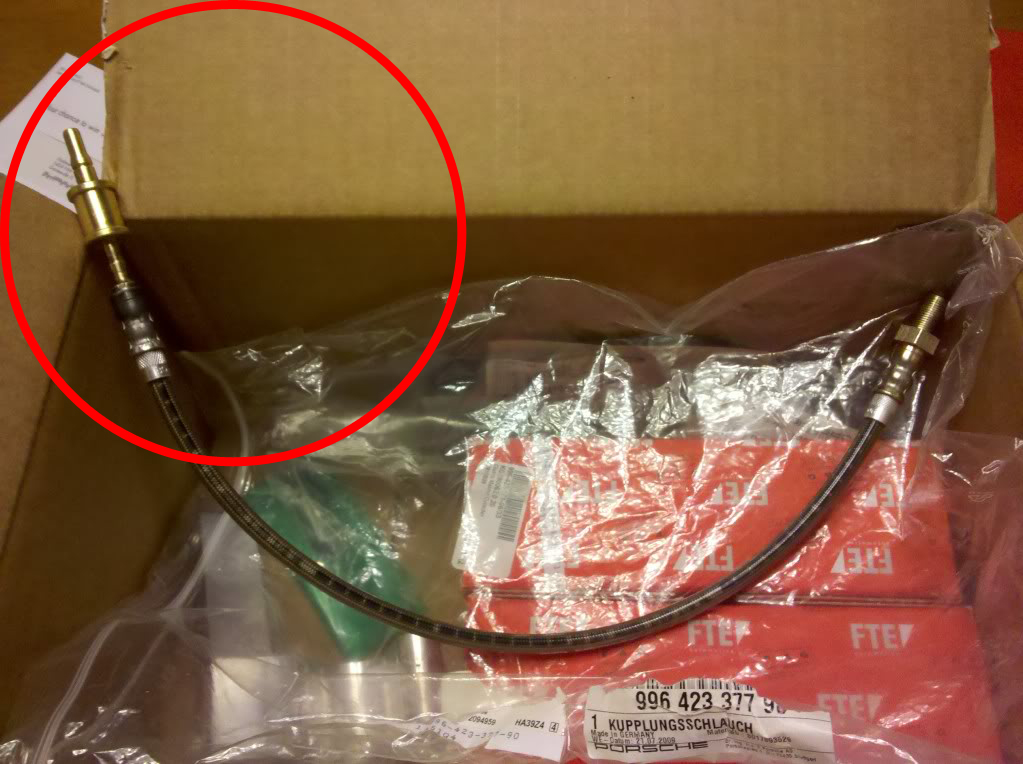

Hey guys, Anyone know the specs on the fittings for the gt2 clutch slave? Im mostly interested in the fitting circled in the picture but any info will be useful.

I searched for a while and didn't find anything. When I had my line made, I was told that it was a Porsche proprietary fitting.

Any info will be helpful, type of fitting, size, gauge if it applies
, source, part number...

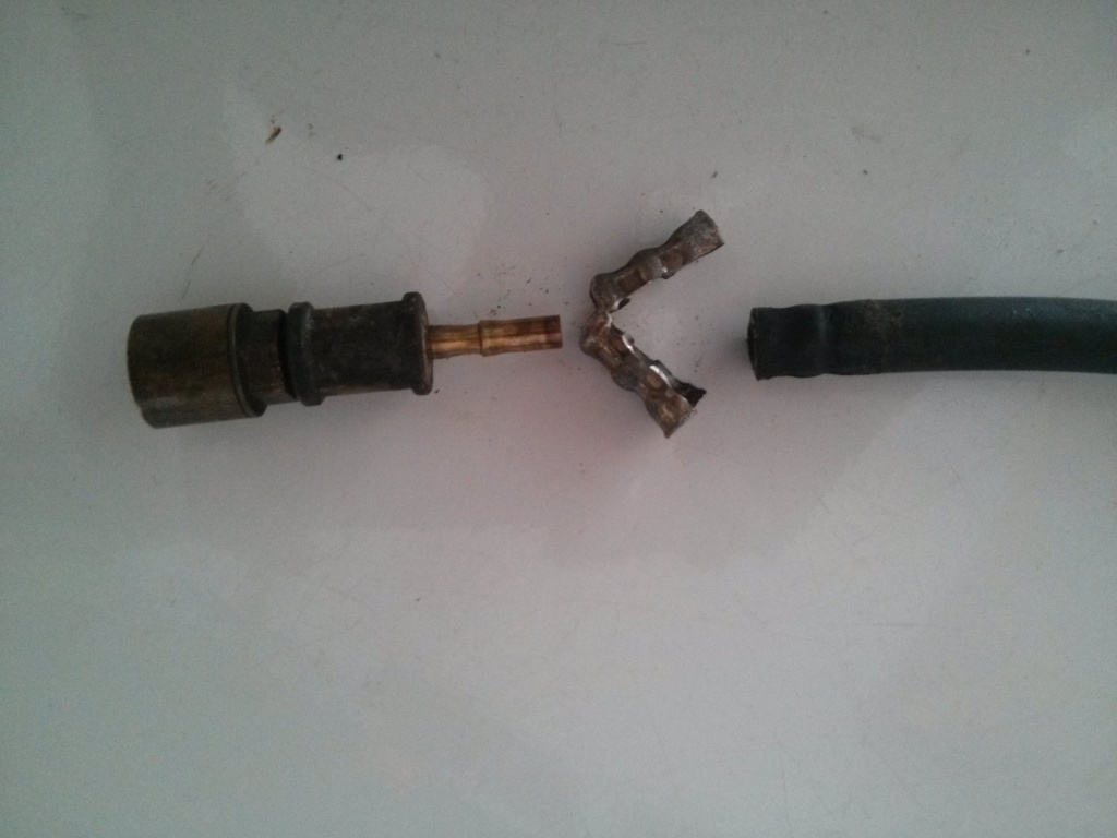

Cut the factory crimp jacket off that fitting and use a -4 push lock and one time use crimp.
Yup, that's exactly what Pirtek did for me. Cost me all of 20 bucks, and they pressure tested it, too.

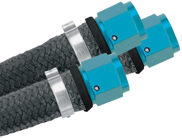

Im thinking this --->
Is this the push lock and crimp your talking about Tim?
