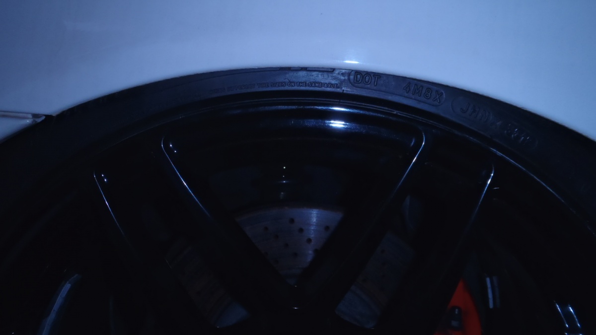

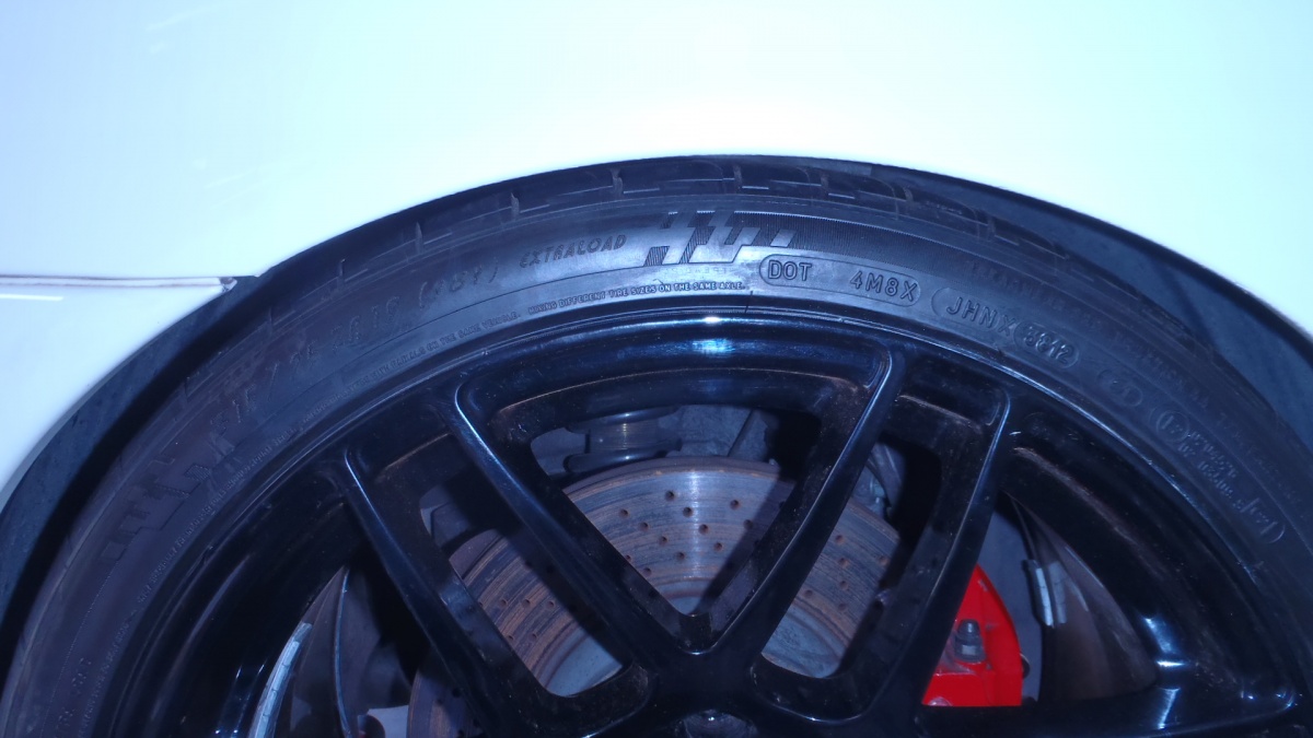

32K, Get your car on jackstands, dislocate your shock and sway bar on one side and then lift up the one wheel and see where it goes. I just used a large bar and wedged it under the tire and the ground and lifted. This way, I could control it and not damage the tire or fender.
I rolled the lip until the sidewall/tire slid by and the tire bottomed in the fender well. As you lift the tire, you will notice it "tucks" into the wheel well on an angle and actually pulls away from the lip due to the suspension geometry. There is less rolling needed than you might think.
Once you roll it and it clears, I installed the shock and sway bar and lowered the CAR with some heavy patio pavers under one tire to see how much suspension travel I even had. Come to find out, I barely have any as my car is real low and almost on the bump stops! The bump stop barely lets the tire go into the wheel well as it is. I barely had to roll it.
FYI - I have PS2's 315/25/19's on 11.5" F14's(not sure of the offset but its good).
Old Jun 25, 2013 | 03:45 PM
evil 996tt's Avatar
Joined: Jun 2012
Posts: 222
From: evil lair
Rep Power: 33
evil 996tt has much to be proud ofevil 996tt has much to be proud ofevil 996tt has much to be proud ofevil 996tt has much to be proud ofevil 996tt has much to be proud ofevil 996tt has much to be proud ofevil 996tt has much to be proud ofevil 996tt has much to be proud ofevil 996tt has much to be proud of
First pic is regular ride height
Second pick is lowered on blocks
Third pic is suspension disconnected and wheel stuffed into the wheel well.
I honestly think I have 1" suspension travel in the rear!
