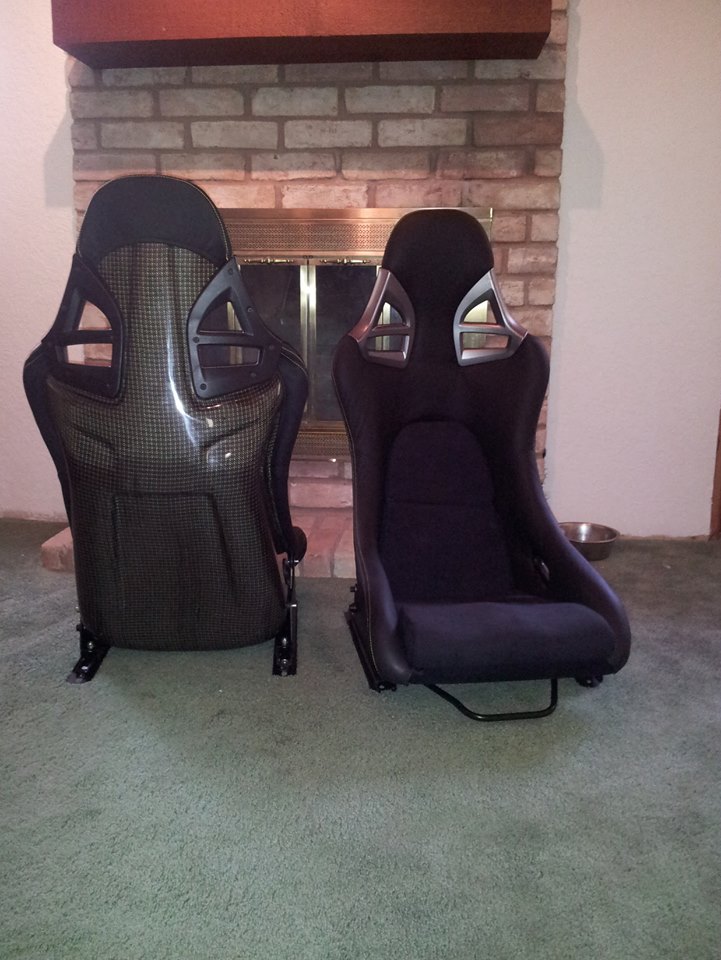

I recently ordered a set of Rottec Carrera GT style (sCGT) seats. Upgrades on my set included carbon kevlar shells and alcantara cushions. The other upholstery is the standard leatherette.
Pros: I am really impressed with the carbon work. The shell feels very strong, the weave is uniform, and the resin is glossy and clear.
The padding isn't that thick but the seat is shaped just right so you're not putting too much pressure on any one part of your back or legs.
The leatherette is actually nice and soft. If you pinch it you can tell it is thin and not real leather but if you just caress it it feels softer than many real leathers.
Ray was easy to deal with and generally answered emails in a timely fashion.
Cons: I'm not that impressed with the rails. This is my first foray into aftermarket seats so I'm not sure if it's normal or not. It's not a problem with the adjuster as that engages confidently. The base metal just has some flex in it. I may break out the welder and attempt to strengthen these pieces.
I'm mixed on the silver plastic seatbelt holes. Sometimes they look cool but sometimes they look cheap compared to the rest of the car. They offer carbon pieces as an option which might be worth it for some. I tried covering with brushed aluminum wrap but the piece was too deeply contoured. I may just try plastidip (though I hate this craze) and see if just making them black and more subtle works better. Or I may do nothing because it's not a big deal.
It took a week to ship even though the seats were on hand.
In summary I am very happy with my purchase. It makes driving the car feel totally different. I lost about 80 pounds by swapping in these seats and removing the rear seats. These seats weigh 26 pounds a piece.
I think the price isn't bad. I would probably pay more for higher quality rails. I think Rottec would benefit from sourcing some for future seats. Although my seats arrived undamaged I would also recommend they use more bubble wrap on the rails so they don't poke through the box.
Keep in mind, these seats are TIGHT. I wear a size 32 pants and have a fit build. They are just right for me. If you are a bigger guy you'll want to look into one of their other designs.
(Feel free to make fun of the horrible green carpet. It's getting ripped out soon.)

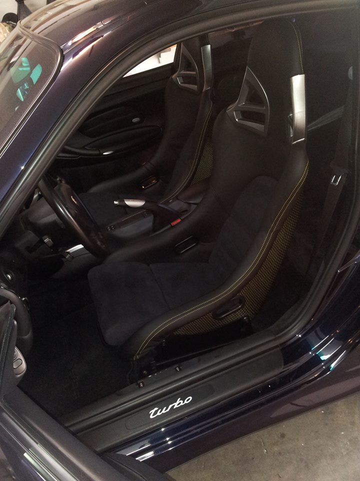

The seats look nice and improve the aesthetics of your interior. But you mentioned your mounting brackets on the base flex? I guess I'm just not comfortable with non FIA or Chinese aftermarket race seats that are installed in modified high performance vehicles.

Or has anyone heard of Wedge? These look like they would raise the seat up higher than stock.
