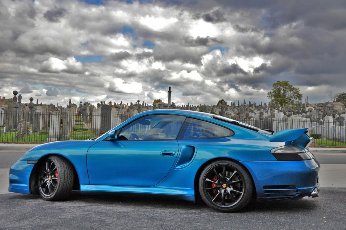

I normally dislike tinted tails but the 996TTs are just so damn big and old that I wanted to tone them down. I was either going to smoke the red or the white, ultimately I decided red. I didn't want the tail light film because the gloss gets toned down and with a grainy texture. I decided to have the tails tinted with paint. Tinting with paint is pretty simple because its just clearcoat with a touch of paint mixed into it. They just fine-sanded the plastic where the tinted clearcoat would go to help it grip better. I'd say the hardest part is choosing how dark you want to go and also making sure your painted tints them both evenly. Once the color was correct two more hands of normal clearcoat was added and then wet-sanded then finally compounded. Not for everyone. In normal light they look dark red, in low light they look a bit darker. Cost me $100.
Car's a bit dirty here but you get the idea:

Looks good! Thanx for the info. Suprised so many are a fan of stock lights. Was on my to do list before I even got car, look dated IMO. But to each their own

DYL, your car looks sick. please post more pics, especially of the front. Looks like you put a 997TT front bumper on.
