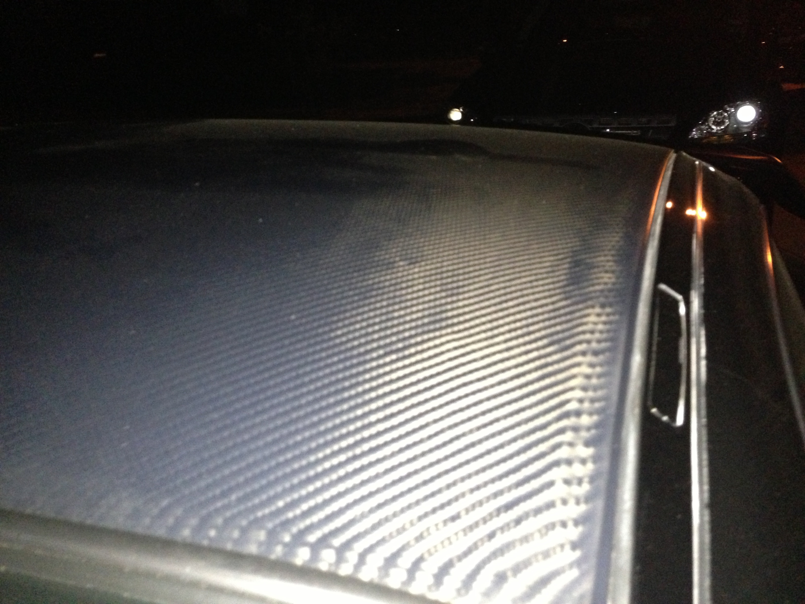

Never had a prob in 8 yrs with carbon roof.

how is this roof installed vs the weld and seal of a metal roof?

They are glued in

Same epoxy the corvette uses.
