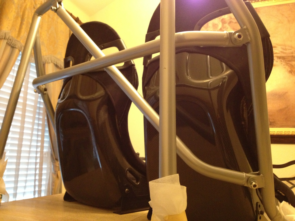

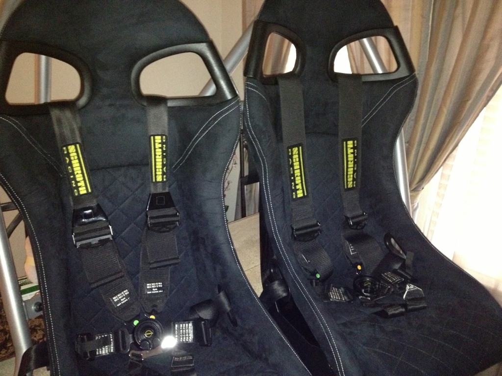

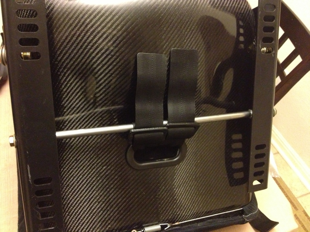

here is a set of ROTtec seats I picked up in alcantera with carbon shells. I made the sub bar mount myself.
[IMG]https://www.6speedonline.com/forums/attachment.php?attachmentid=258550&dateline=137332 5199[/MG]
[IMG]https://www.6speedonline.com/forums/attachment.php?attachmentid=258551&dateline=137332 5199[/MG]
[IMG]https://www.6speedonline.com/forums/attachment.php?attachmentid=258552&dateline=137332 5199[IMG]
What do you think of the rails? I think I'm going to swap mine out for some other aftermarket rails.
