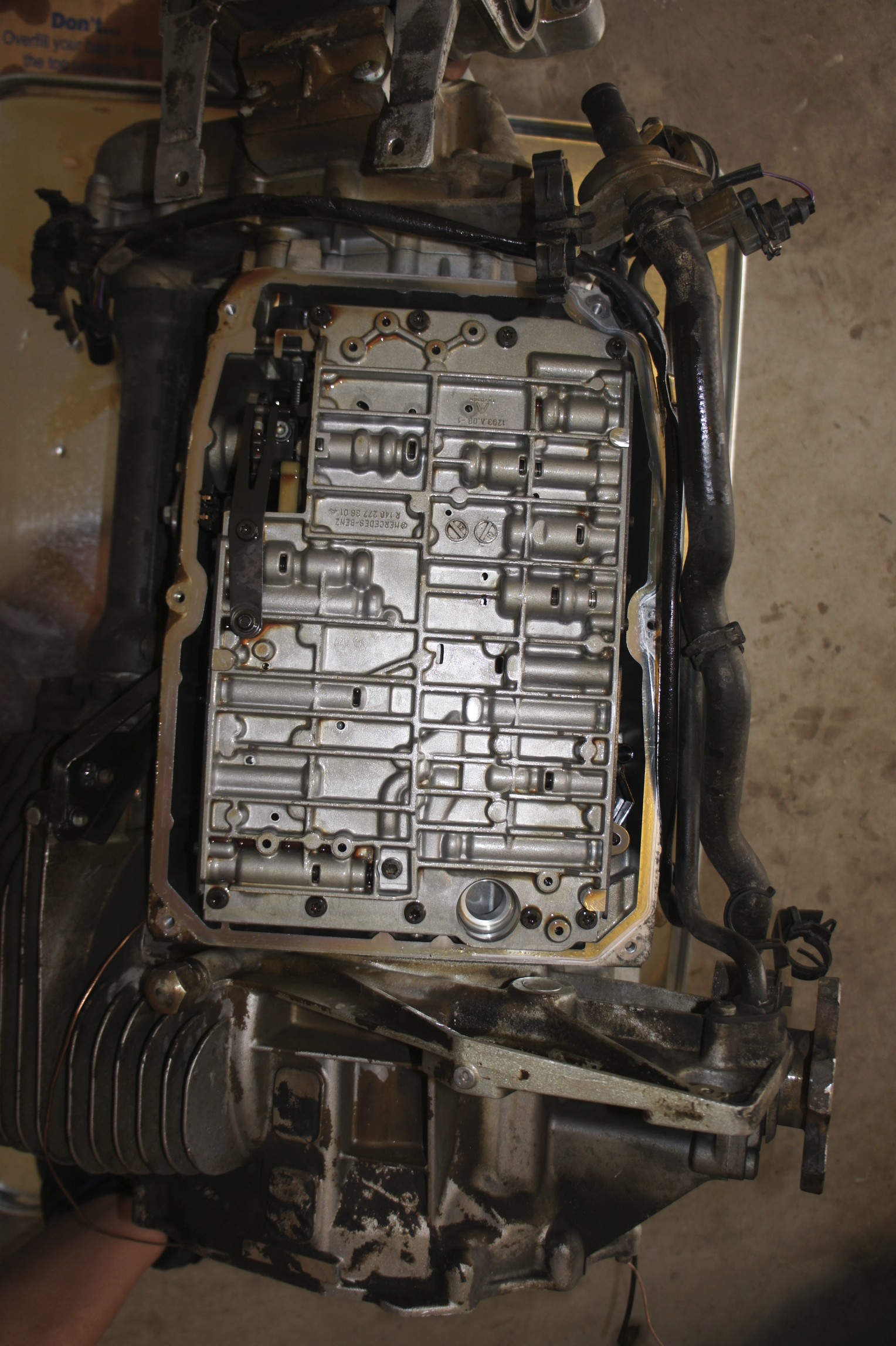

speed sensor is part of the conductor plate and transmission does not need removal for this. this link will show you how simple the VB access is.
it is a very simple process to replace the plate itself. it requires removing the transmission pan, filter, and valve body which is all easy to do. even putting it back together is a pretty simple process but replacing the fluid and getting the fluid level back into correct tolerance is critical. too much, too little. or the wrong kind of transmission fluid is asking for trouble. any porsche dealer or mercedes dealer should be able to do this and for not much more than a transmission fluid/filter change. its about 30 minutes more work at most!
picture 1 shows tranny pan removed ( maybe 6 bolts) visible is the bottom of VB. pic 2 shows top of VB after removal (10-13 screws maybe) with black conductor plate which snaps in place once solenoids are removed. 3rd pic shows VB and conductor plate removed.
