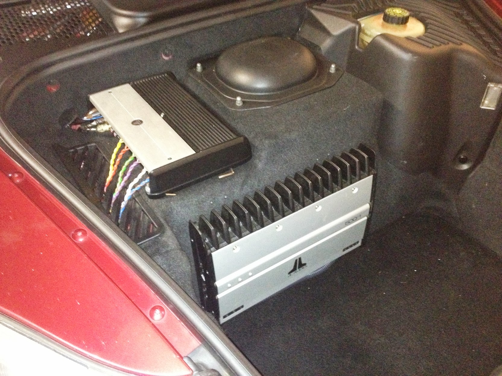

I am running two external amps - 6-channel Jl Audio for the cabin speakers and a JL mono amp for the subwoofer. You do not have to go crazy with a subwoofer, but the 6-channel JL amp is the way to go if you want good sound quality. It is also very small as you can see in the pic below. I opted not to install it in the factory amp location as it will not get enough air for cooling. I upgraded all six speakers with components that have outboard crossovers. Or, if I had used regular two-ways I had the option of tuning the frequency directly from the amplifier to each set of speakers (front, door, rear). There are options.
You can easily install the amp below and use your existing speakers until you are ready to upgrade - rca direct to amp, then amp to all six channels with no "true" fader control. It will still sound much better than the head unit or oem amp.
JL Audio XD 600/6 Specs

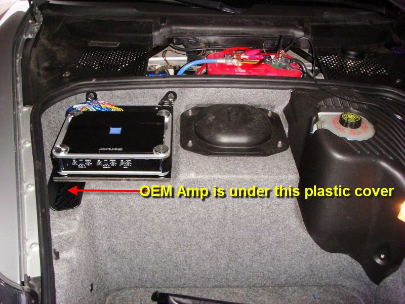

Here's my Alpine 8" navi
http://www.flickr.com/photos/99558942@N08/9385748072/and amp board
http://www.flickr.com/photos/99558942@N08/9385746566/

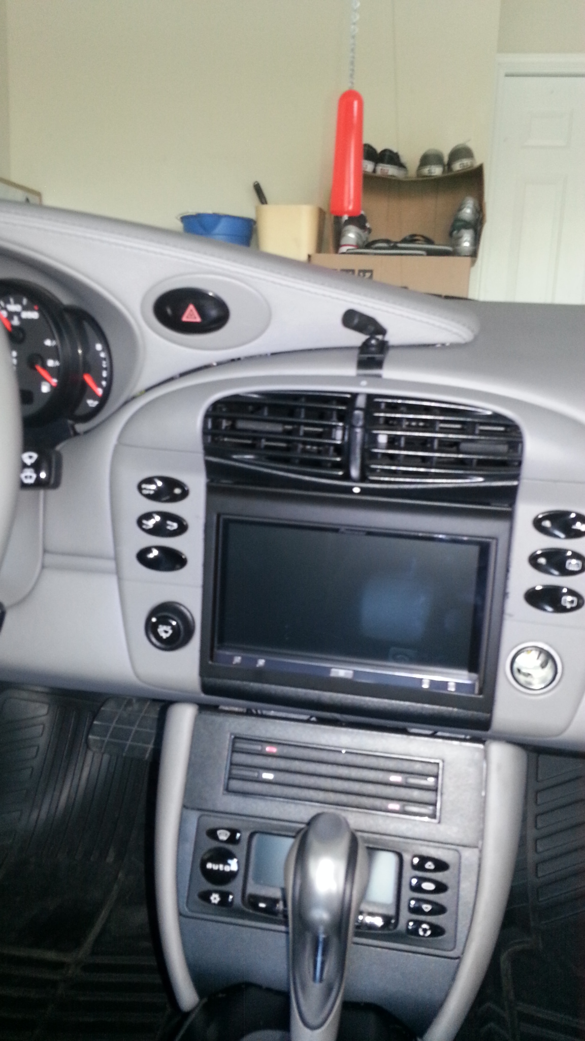

Here's my non-working setup so far.
