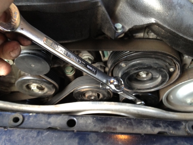

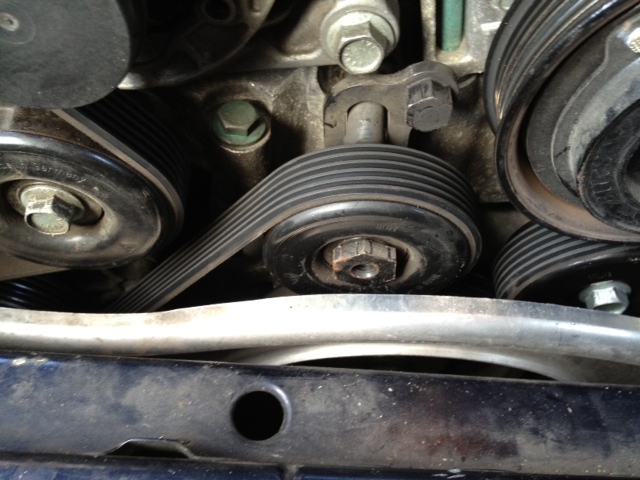

2) Loosen idler pulley bolt (mine was a 15MM, but the new one was a star head) Picture attached of my wrench trick to get more torque

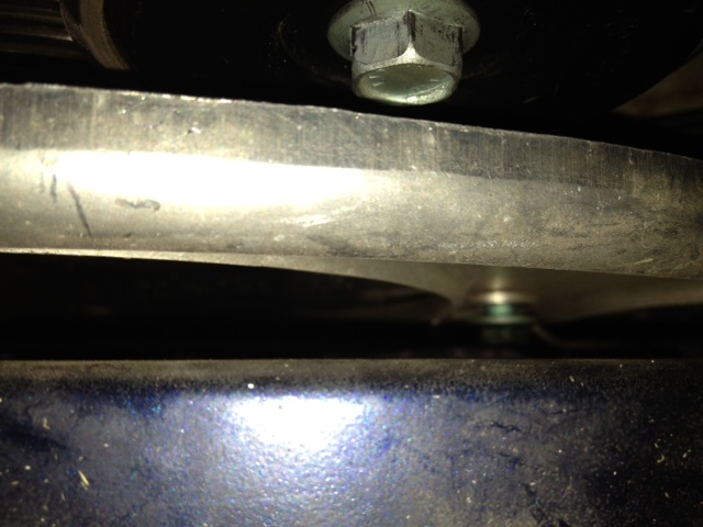

3) Loosen the 15MM carrier shield bolts (2 of them) Picture Attached
4) Remove the tension from the tensioner pulley with a 15MM socket (Slip off the belt (as little as possible)) Picture Attached
5) Remove the 15MM bolt from the idler pulley. (This is not easy because it hits the shield, so I took a block and pried the shield back. I only needed about 1/4-3/8 extra distance which I got from the loosened carrier shield bolts above)

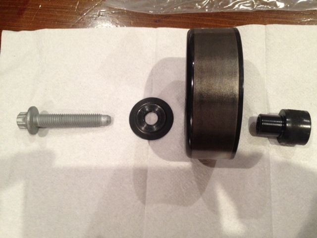

6) With the bolt out, you can pull the pulley apart. (didn't know this until I went to put the new one in.) Picture Attached
7) Time to put the new parts in. (I had to remove the O'ring from the new bolt so I could install it in pieces, which would have made one more hand nice.)
