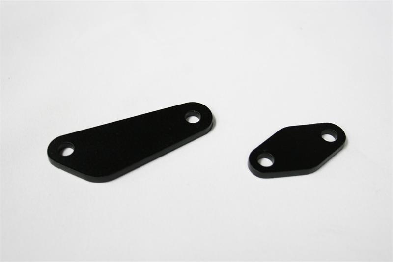

GSR Porsche secondary air pump block off plates
http://store.gospecracing.com/boxste...entline-1.aspx
Link below discusses blanking plates from the factory and changing DME to ROW (Rest-of-World) to bypass the secondary air pump and after Catalytic O2 Oxygen sensors for NA 996/986. Does this apply to TT cars and is the procedure/parts the same?
http://www.renntrack.com/forums/show...jection-system
