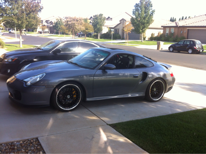

Just my .02 ... Put on 19 this past weekend, drove it for about an hour and so far I'm liking it. I went with 997tt fit because I found a used set of HRE's for a steal. 8.5 et51 235/35/19 front & 11.5 et43 305/30/19 rear. Had to put a 7mm spacer on the rear so it wouldn't rub (adjusted the rear fender liner bracket with John's advise - thanks powdrhound). RWD only so no worries about the front diff. I will hold on to my 18's for track days but for everyday 19's look great.

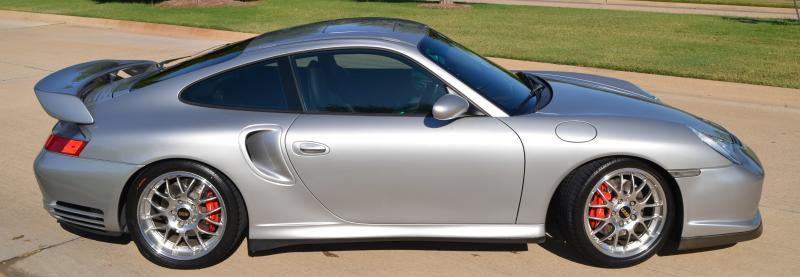

I always hated the stock Turbo wheels. Found a set of BBS RS-GT's that were the stock size and they look great on my car with H&R springs. I'm running 235/40 front, 315/30 rear. Many people have said that they look like 19's on my car. I think lowering the car a bit is key.
